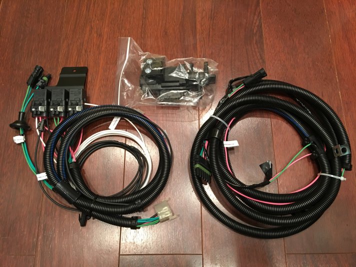

I've got NEW harnesses available.....new dash switch, 65 psi valve, wiring, ect if you want to go all NEW.
