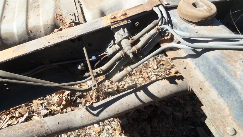

Also, my fuel rail on the 5.3 has a return on it, if I how with the dual tanks, would that be run to the selector valve, or to the tank/s?
Yes, the fuel selector valve has provisions for returns, That's why there is humpteen million hoses going to and from it.
