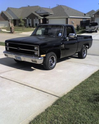

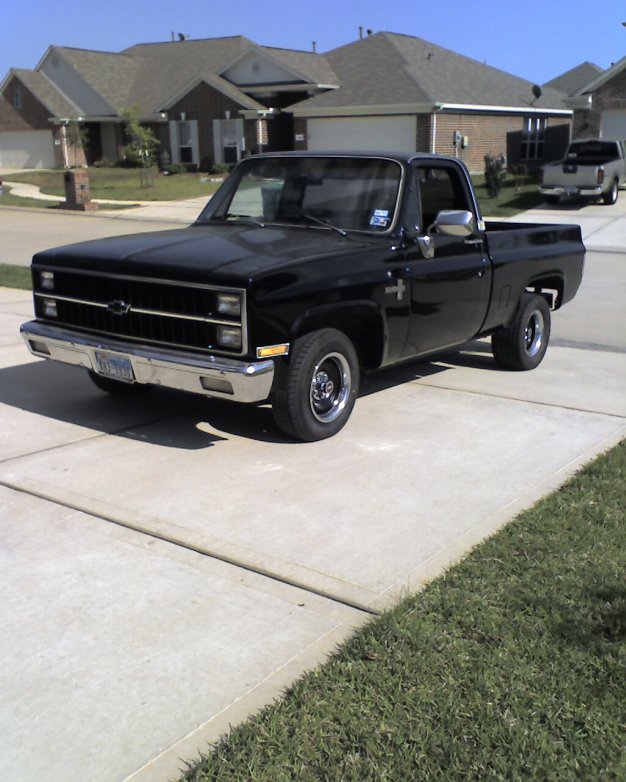

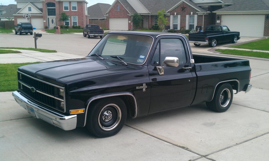

1. Stock
2. 2/4in drop.
3. 4.5/5in drop.
You can install a drop kit in about 4 to 8 hours depending on your skill level and tools available.
It would be easier to know what you plan to use the truck for and how low you want to go to be able to give you the best answers to your questions.

My 1st pic has a rake also, the driveway slopes so I guess its an optical illusion that its level.
These trucks all have a 2in rake from the factory so a 2in drop shackle will give you the level look you are wanting. Its an easy install but you will have to notch the bed brace above the shackle for it to fit.
Personally I think you would be happier with a 2/4in or a 2.5/4in drop. This takes the "sky jacked look" out of the front and the rear but still able to use the truck as a truck if the need comes up.

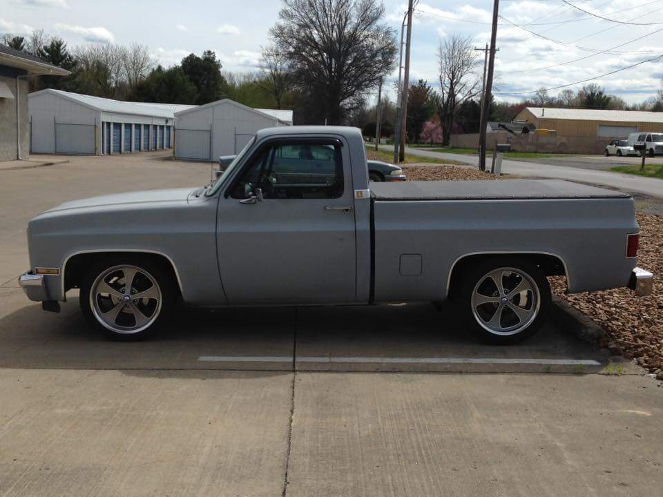

Here's what two coils cut in front and removed helper spring in rear looks like. I have a little take but I'm also running 245 45 20 front and 275 45 20 rear

It rides fine, I don't think you'll really notice much of a difference, might go with a decent new shock to make up for the helper spring.
