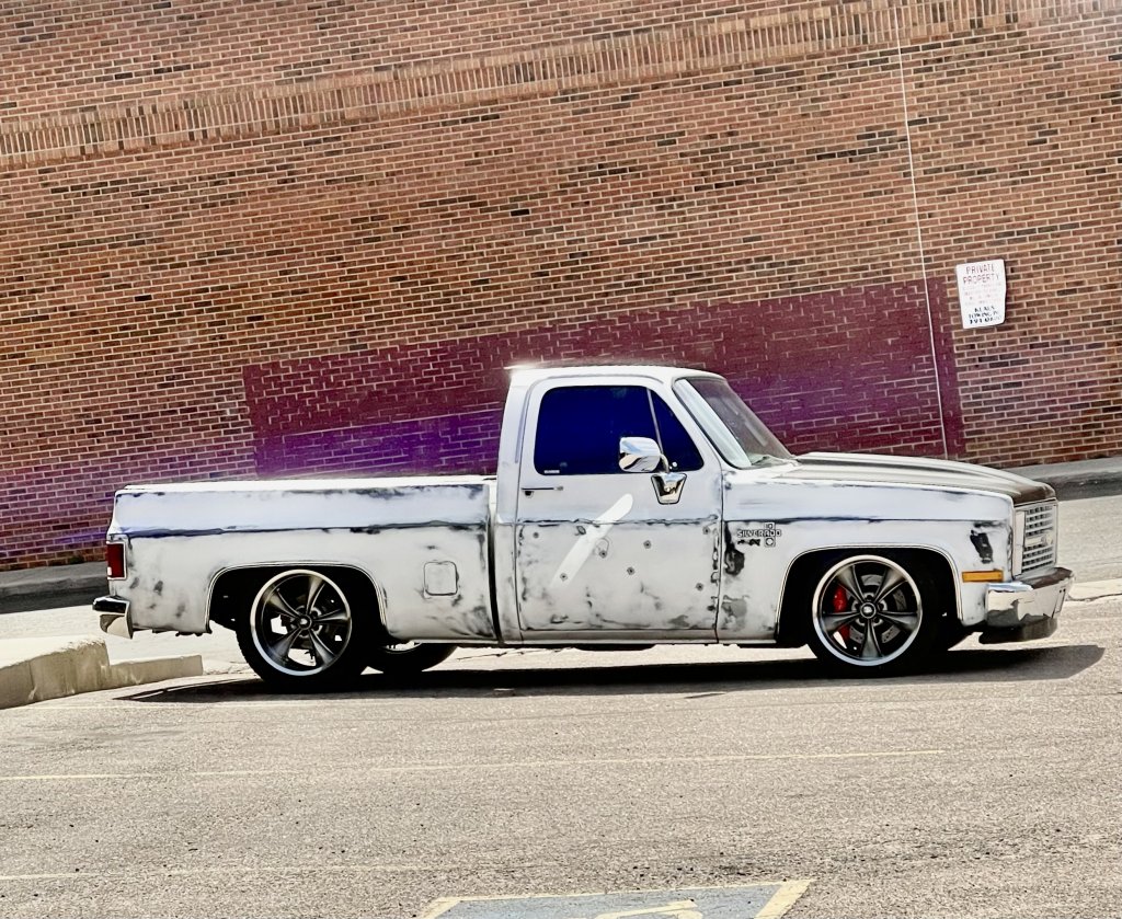

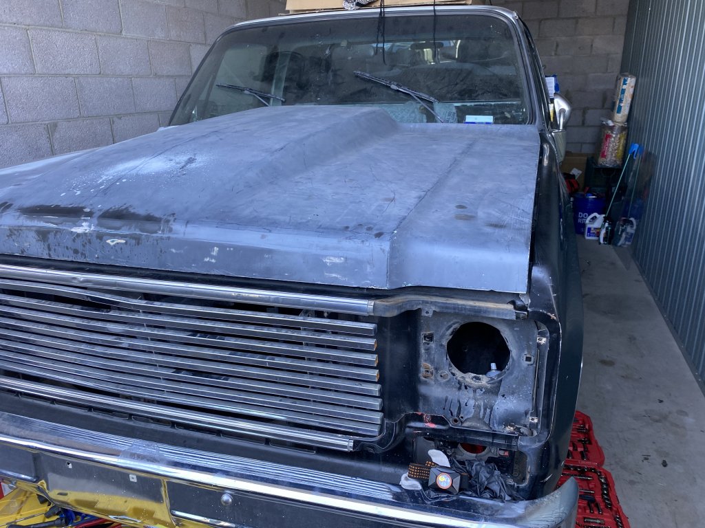

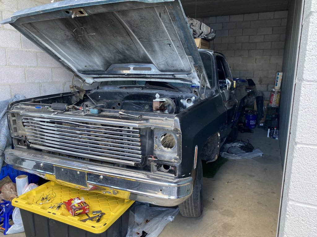

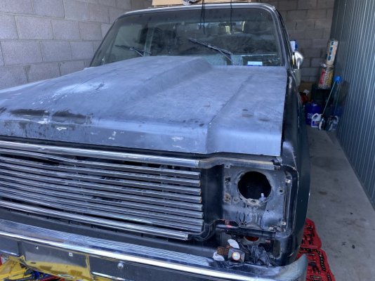

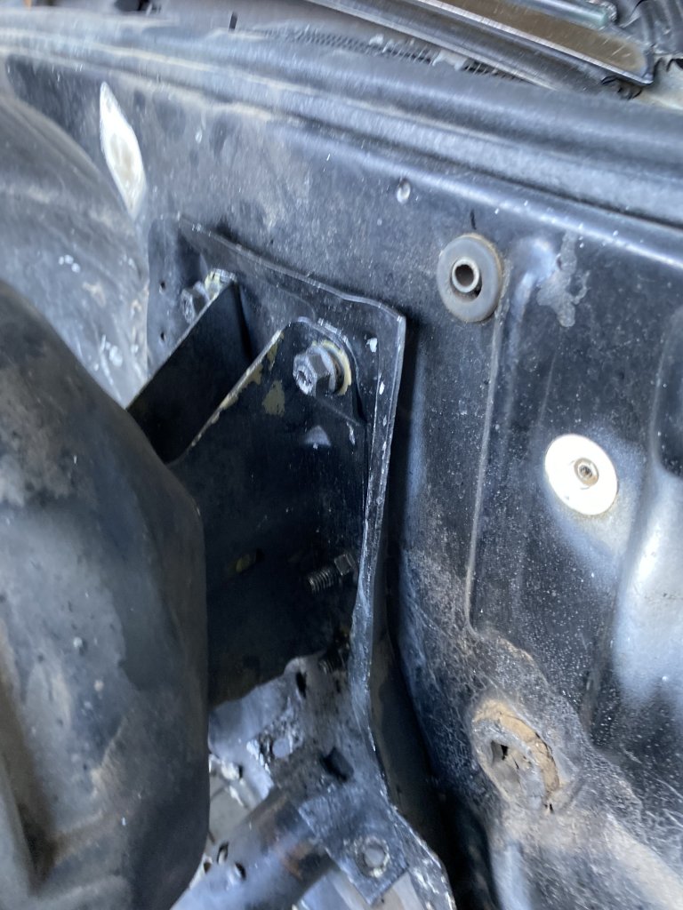

I’ve come to finally get the controls arms off and now I’m putting new ball joints away bushings and so on I’ve come to the point of taking side finders off and hood. Anyone know what I can or how to measure my current spindles and rotors to see if the truck was lowered already I know to cut a spring off one but one but what’s the real measurements of the spring to say drop it 4 inches in front? 5-6 in rear? Also if I cut the springs as per instructed by a member of this chat group what would the spindles be and or rotors ? As well as calipers and rear breaks installed what’s the best I could get keep in mind I only shop at “Napa” not auto zone lol also I took some pictures of what id like to do to my truck however I’m not cutting the frame up if I have too I’ll build a new kit to drop safely and not take the value off my truck

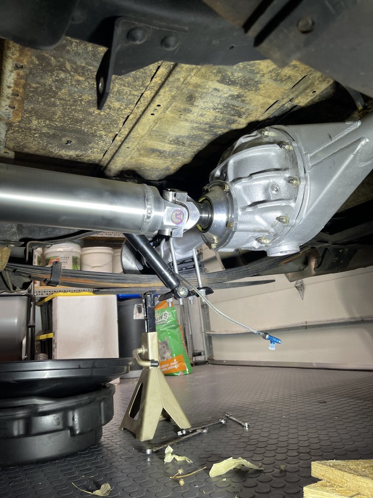

If you flip the rear without spacers on top of the springs you could get away without a notch, but for the 7” lower (which just means 2” blocks on top, it needs a notch and the rear will just about be touching the bottom of the bed. In this pic I have it flipped and 2” spacer under the rear, 2.5” drop spindles and 2” lowered springs 20” wheels
