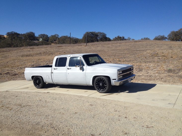

Zone cone
Apr 25, 2013
Templeton
Shannon
Here's my 84
