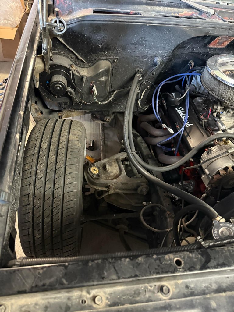

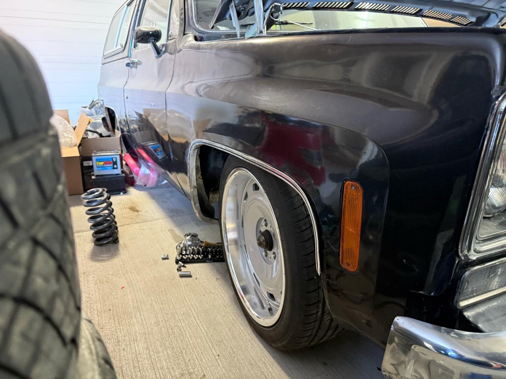

Lowered my 78 jimmy rwd with a bell tech 4/6
Back end dropped 8” since I didn’t re arch the leafs. From is dropped 6” with drop spindle and 3” lowering spring from brothers truck.
Removed the inner fenders to make sure there was no rubbing issues ( building new inner fenders for replace)
Only down side is the front coils pop out of top mount when the suspension is drooped. Considering limiting straps to stop this from happening.

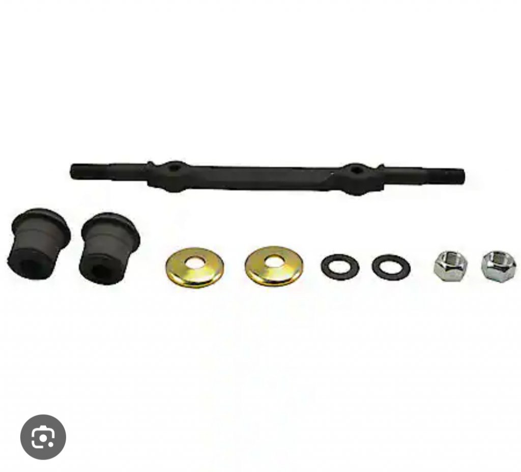

Did you look at moog problem solver k6184 offset control arm shafts?
This
With these I had no trouble getting mine aligned even on bags. Except for wanting the ride height to be tucking wheel which got in the way of sensor mounting lol
