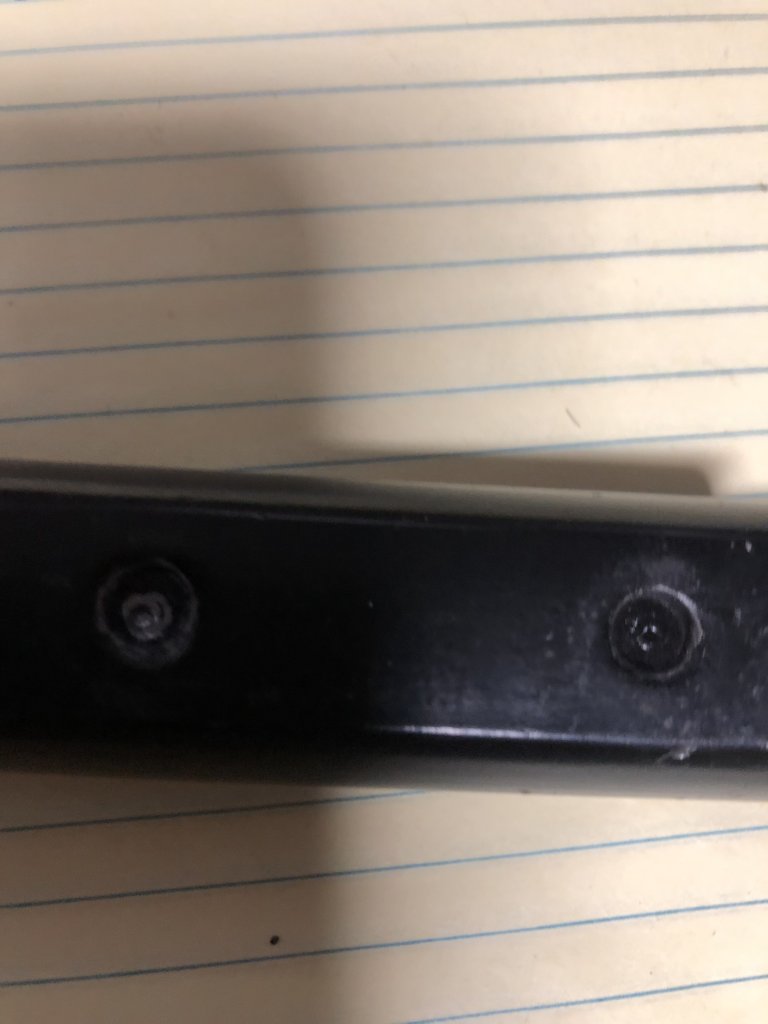

Found a Aftermarket one on Ebay for $ 46.00 Free Shipping However no plastic to melt out, Looks like it was pressed punched together, Tried to punch it out Nope
Will try to drillit out??

I was wondering if anyone has seen this type of Shaft and how to get it to slide
