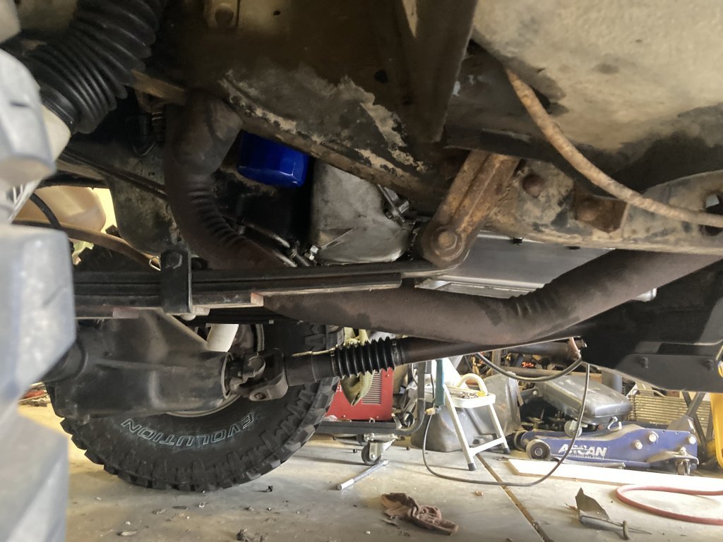

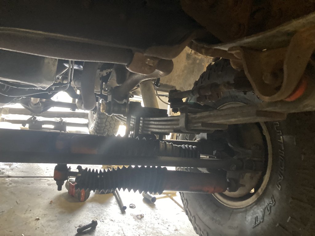

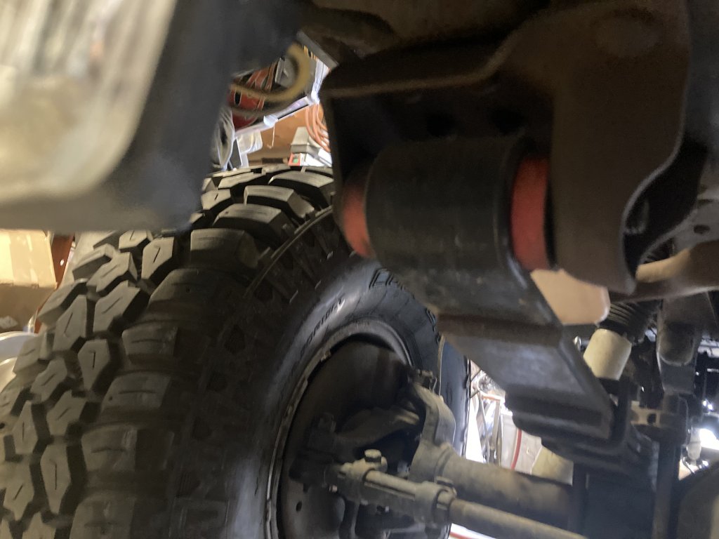

Pics of leaves included. 5 leaf, 3/8 thick. It does have Procomp ES9000 shocks.
Edit: Verified 4" lift- 12.5" frame to tube

30,415
28,229
Looks like 4" springs. A buddy of mine used to have a truck with Pro Comp springs, iirc they were built like those. Pretty sure the bushings were red too.
I remember for certain that the truck rode like a log wagon though. No forgetting that part, lol.
