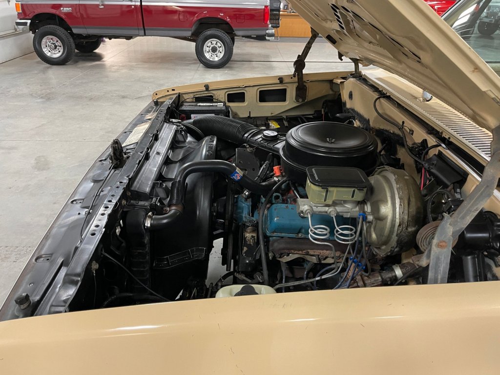

I haven't dug into it yet, but after hours of heavy rain I had a trickle of water from under the dash, drivers side left of steering column. I have the dash pad pulled out, not coming from the windshield seal...is it coming from where the firewall meets the cab under the cowl? The only reason it was obvious is because I have removed the floor mat to install sound insulation. Time permitting I will remove the insulation from around the column/pedal cluster and see what I see. Might be time to do some welding. It might be a good idea to yank the engine and seal it up, and look for any issues in the engine compartment. Looks vey clean from upstairs. Then I could clean up the wiring from the ESC delete and get a set of wires with loose distributor end terminals and get rid of the sloppy universal set. If I have the time.
