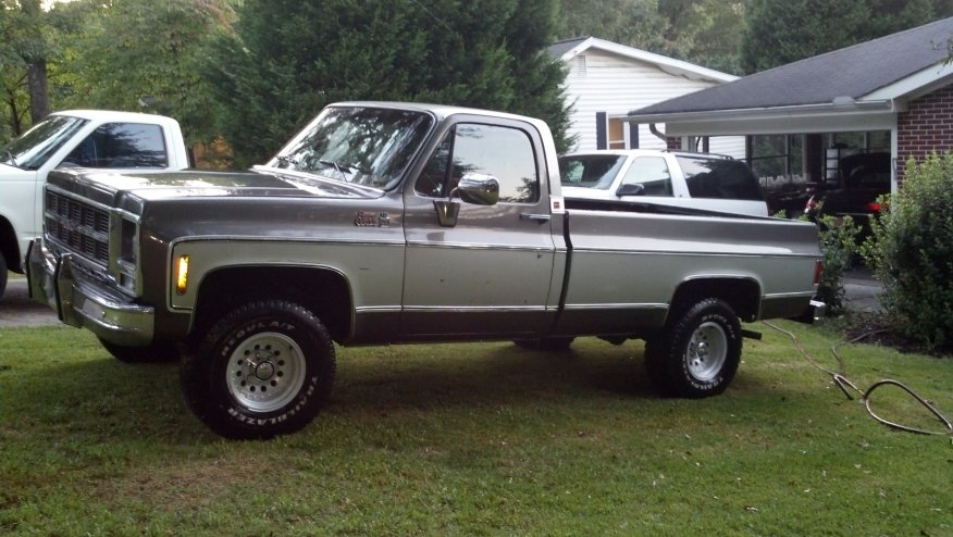

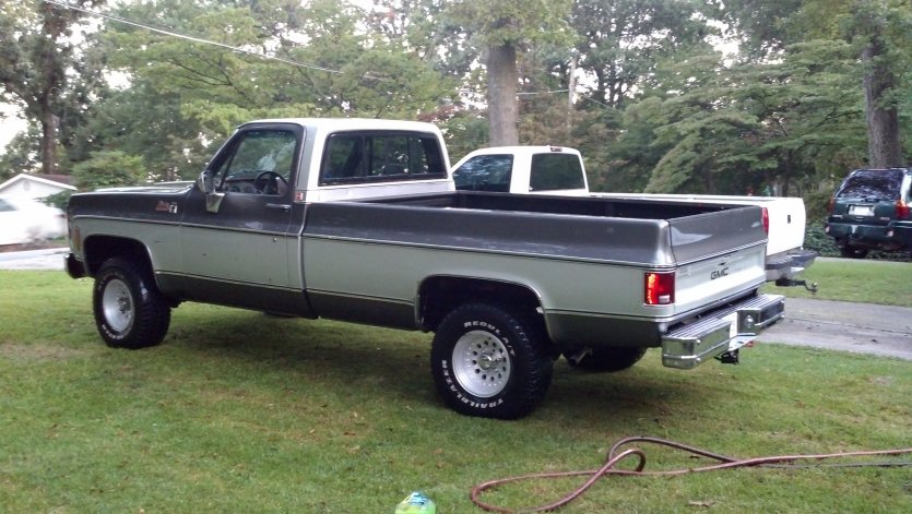

Well, had a great weekend working on the truck and then...driving it.
I got the pushrod drilled out to install on the brake pedal and got that buttoned up. Then got the driver's side exhaust completely hung. I'm loving my $240 Jegs pipe and muffler kit - especially after Midas tried to rape me for $900 to put pipes under it. Went ahead and spent the money to have the wheels swapped out (had a slight problem when it turned out that the lugnuts which came with the wheels were M12x1.5 and would spin on and tighten down until you put an impact gun on them - then just spin. So I was able to quickly source 12 - 7/16x20 mag seat nuts down the street to get 3 on each wheel and drive away.) Found 12 more the next day.

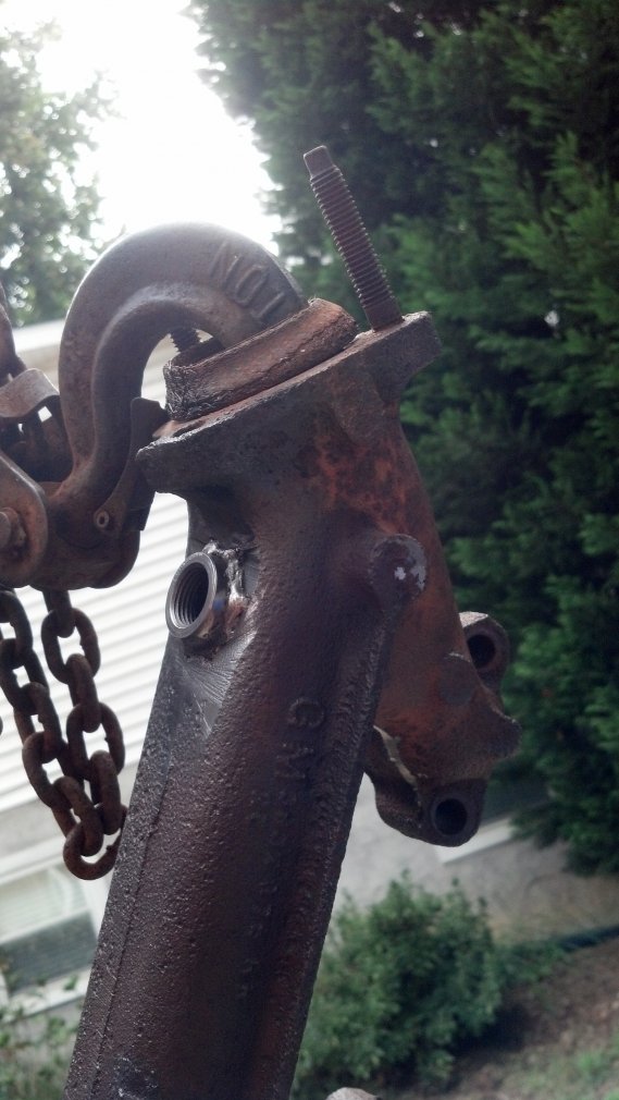

Drilled my new TBI right side manifold and welded on a O2 sensor bung, painted the manifold and swapped out my old LM1 manifold (with a massively leaky heat riser valve) for the new with a doughnut to seal it up. Finished off that side of the exhaust and cleared the codes, cranked back up and got a nice oscillating signal from both pre-cat O2 sensors.
Still has a pending code for #6 misfire (probably needs a spider) but I can't put $400 towards that right now. All other codes are 4L60E-related which I guess I'll just have tuned out. Oddly is hasn't thrown a rear O2 code and those harnesses are cut off. Still having fuel gauge problems and i know it's not the ground because the fuel pump shares that ground and it works fine.
Brakes still have some life in them but I should do them when i save the scratch for shocks. Have half a mind to go ahead and put 4" into it with some used lift kits coming with good shocks for only $100 more than just shocks would cost.
I'm thankful autumn and winter are coming and i can use the good heat and wait for the AC expenditures.
Here' s the new pics

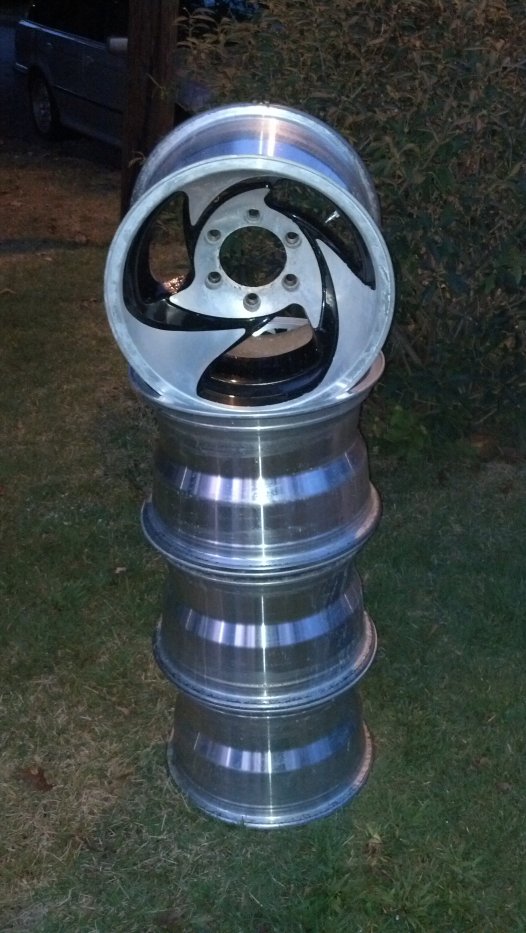

Oh, and I now have a set of aluminum 15x10 6-lug wheels for sale. I'll even spray them plastidip black for the right price. They're in Atlanta metro and probably not worth shipping.
