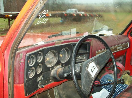

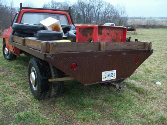

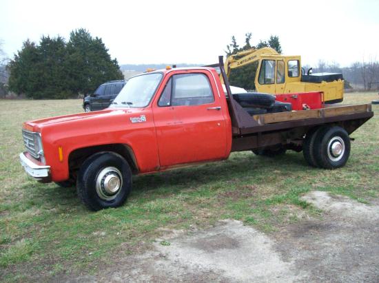

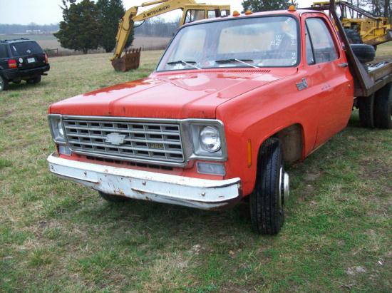

no dream hotrod here is the pics.interior is rough but the body is very good. im been using it to haul 2 cord of firewood, scrap metal, and other junk with it. this is before i put mirrors on it. i paid 500$ for it.

That's a good work truck. No frills, no ********, less to go wrong, less **** in the way to work on it etc. Looks to be in solid shape. I've seen lots worse interiors too. A good cleaning of that interior with some Deep Purple water solution and rag will go a long way, then get a dash pad cover, and it can be very presentable as is. You should be able to make a few bucks with that truck hauling firewood and scrap iron/steel.

yeah the interior needs help. i did pull the hubcaps and put them up to keep them from getting damaged, lost or stolen. im still getting use to the hydro boost brakes as it is quite sensitive.

I thought those hub caps were pretty cool. I've never seen those before. They appear to be OEM too.
