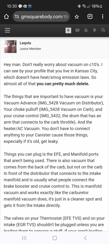

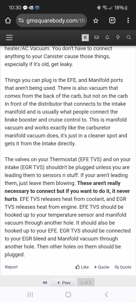

I knew what I was doing, I've been reading "Haynes Repair Manual" which shows almost everything in my truck. The only things I've kept hooked up to Vacuum is my HVAC, My Brake Booster, my transmission and Vacuum Advance and sensors (except my EGR Bleed)
1. I unhooked my EFE, and plugged the EFE TVS with Caps since I had a different breather connected up where it wouldn't be pushing the exhaust gases back in to the engine to heat the engine and I made sure it was open and stayed that way.
2. I unhooked my Cruise Control, and Vacuum hold ball since this thing ain't ever travelling, and also it had a hissing sound when connected to vacuum.
3. I deleted my Canister because the only thing it seemed to have been hooked up to is an old, long, worn out rubber tube that used to lead to the EGR, and then hooked up with the PCV valve. It wasn't really doin' much except causing a vacuum leak. It was also really small and only had two points, where as I look at the Vacuum Diagram there is supposed to be three so prob aftermarket crap.

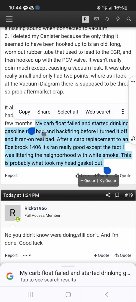

It also wasn't running right, that's why I deleted it. It had poor acceleration before and ran fine for about a few months. My carb float failed and started drinking gasoline real bad and backfiring before I turned it off and it ran-on real bad. After a carb replacement to an Edelbrock 1406 It's ran really good except the fact I was littering the neighborhood with white smoke. This is probably what took my head gasket out.

No you didn't know were doing,still don't. And I'm done. Good luck

This is a self repair. Ive been learning for about a year from mutiple mechanic neighbors. the EFE and EGR tvs valves are Plunger Acuated Valves. It doesn't pull air from the intake or thermostat, it redirects it based on conditions. It doesn't need to be plugged whatsoever, since they Don't work without a vacuum source connected from the carb/intake ports.
