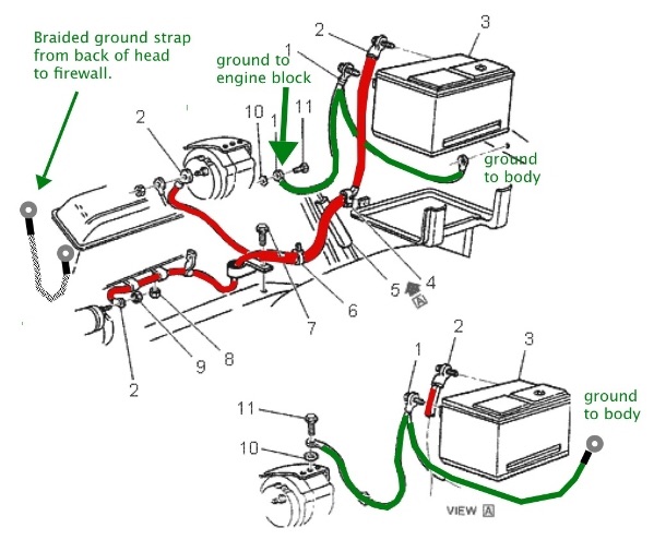

Have you had a chance to check all the grounds yet? I'll attach a diagram that shows those plus your hot lead to the starter solenoid. If those are good and still the same issues, check for voltage drop across that red lead by testing it close to the battery and close to the solenoid. If your voltage drop across that wire is greater than one tenth of a volt, your cable has degraded too much, and you need a new one. Maybe do a visual inspection, too, to make sure it's not something chewed or damaged. I wouldn't jump to suspect ignition switch/NSS right away because you are getting some voltage to the starter. If you have or have access to a remote starter switch, now might be the time to break it out and test things if you're impatient. That ground strap is at the passenger side cylinder head, by the way.

Yeah, I checked the voltage at the battery, at the starter, and the hot ignition wire, 12.5 volts, and all the grounds. I'm thinking it's still is the starter or solenoid that is working, but too weak to turn the engine over. I just don't want to drop $130 on a new starter and find out its something else.
