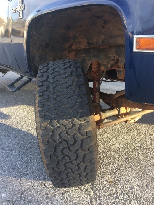

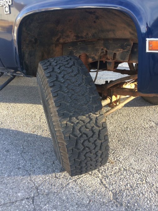

So when I bought my truck, my steering was perfectly fine. I decided to go and have a little bit of fun and do some doughnuts in the dirt. It was fun but as I was pulling out, my steering suddenly got really hard and stiff. It felt like I had no power steering! With the passing of time it got better, I was able to turn the wheel easily while driving but when braking it becomes stiff and I can't turn the wheel at all at a standstill. I think it could possibly be the steering box but not completely 100% positive. Well had parked with my wheel turned and almost flipped out. It's like the camber of something on the steering is totally screwed up. Anybody know what's up or is this normal. I have a 4inch lift on 35 A/T. Thanks!

And camber when the wheel is turned is normal.

Camber looks fine as it will change during turning due to large caster that these trucks have. Check power steering pump to be turning while someome else tries yo turn the steering wheel at idle.
I've never had a square before so I guess it could be right. It just looks a little to exaggerated to me but that's just me. I can't turn the wheel what so ever unless if I'm under power and cruising. With the truck at idle and not rolling, the steering wheel will not turn at all. I'd have to jack it up to do that. And my power steering pump does turn over, there's no slipping at all due to the water pump I just had to replace so I had readjusted the tensions. Maybe it finally just said screw it. I just don't want to buy a pump and it be the steering box or vise versa.
