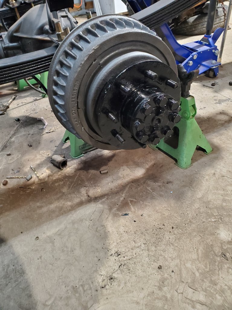

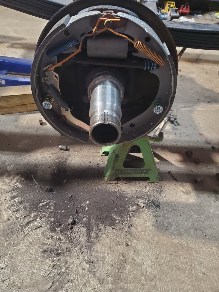

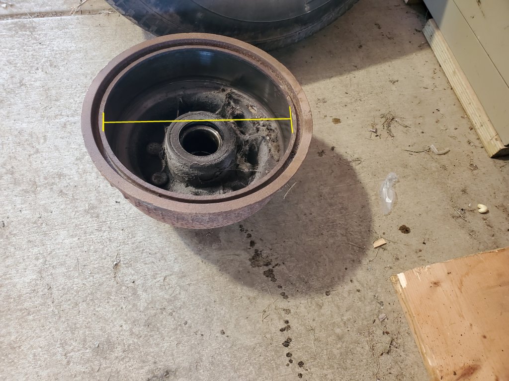

just go take a photo of the drums from under the truck
this is a 14 bolt ff but the reason i ask is usually if there is more than one brake option it may visually be apparent, so it could help
heres a larger k25 brake on 14bolt ff (1980)
here is the same differential with the smaller brakes (1976 but the diameter would be the same)

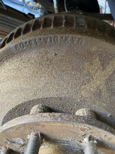

You really don't even have to measure anything... The drum will almost always have a min or max measurement cast into the drum or rotor that you can't machine down past without compromising the drum/rotor. I have an 8600GVW K25 and it has vacuum brakes with the big 13x2.5 rear drums on a 14BFF. The drums had a "13.125 max" cast into them, so it was pretty obvious they weren't the 11" drums

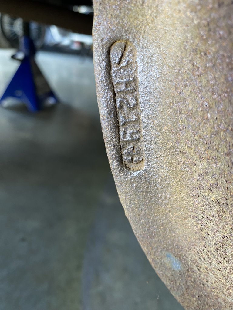

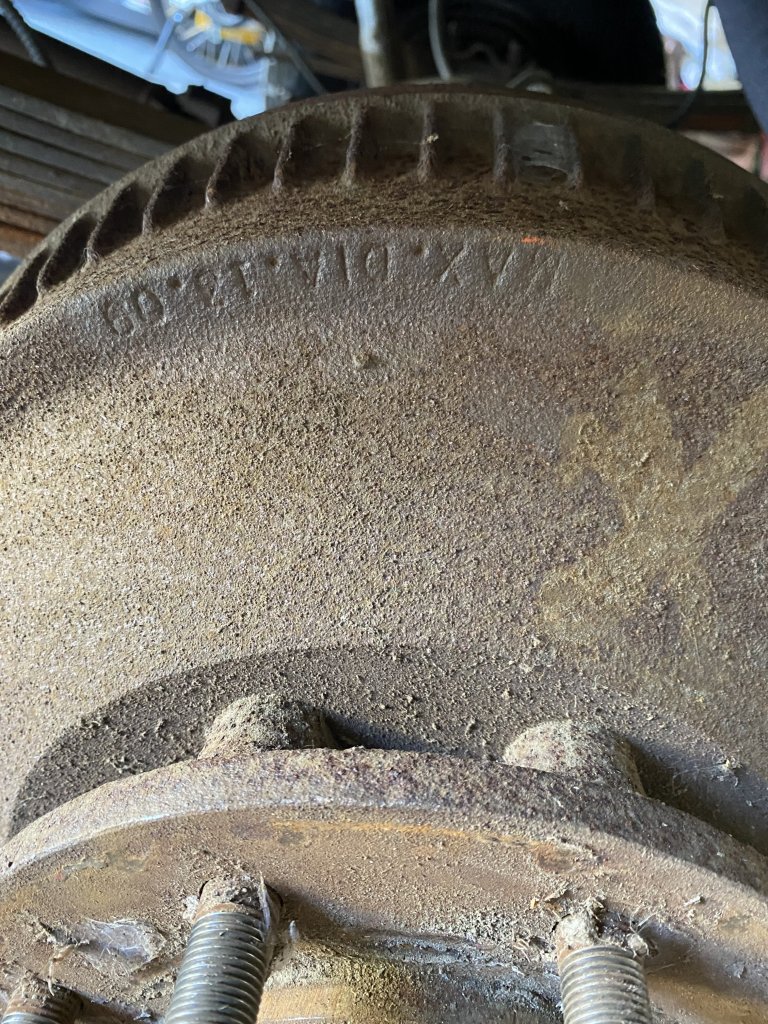

Is this what you mean? I really didn’t want to pull the drum and all that just to have to put it all back together while I order the parts. This looks to me to say max 13”. Does this other stamp on the drum mean anything? Appears to say H219. Should I just order 2 sets of different size shoes just in case since there’s really no guarantee to know before hand? Front disk were 13”, and as far as I can tell the 8600 GVW are JB7 brake option, is this just in reference to the front brake setup? I have the 14 bolt full float w/ hd chassis if it matters.

I enlarged the picture and that actually says 13.09". Most OEM drums have.090" room before they become oversized.
You have the 13"x 2 1/2" drums. I think this is standard on the later 14 bolt semi floating axle equipped trucks.
