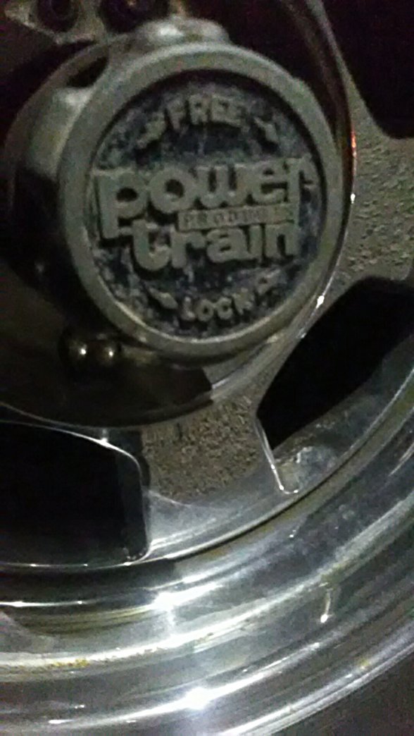

"Power train Products"? Lol? That's what it says!

Those look like old Selectro hubs, other than the name of course. Pretty neat stuff really.
It's hard to tell in the picture, but it looks like you have the old style external locking hubs, held to the wheel hub with bolts. The hubs you found on ebay are for the newer internal style wheel hubs. Those are held on with machine screws.

^ What he said. Those look like selectros, which are indeed external locking hubs. And they do have a bit of a uniqueness factor to them. Your options are not quite as plentiful when it comes to external locking hubs. But I do believe Warn makes a Premium replacement. I have run Warn Premiums on many axles, and never had a problem. They are expensive, but you get what you pay for, and they are lifetime free replacement if you ever break them. Don't know what kind of "wheelspin" wheeling you're doing, but if you need unbreakable, then you need to get drive flanges, not locking hubs.

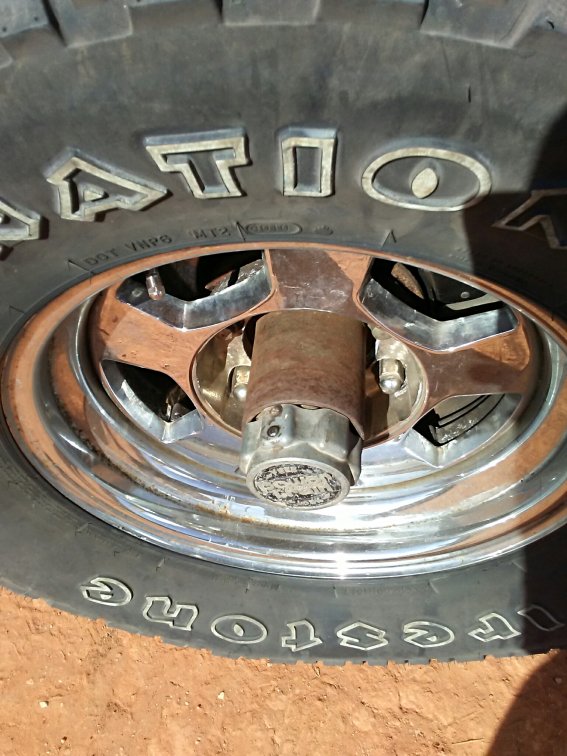

These caps appear to be RIVETED and J-B weld? Fun.
I was thinkin bout it though and I reckoned they are likely seized up or somethin since they PROBABLY require some sort of maintenance. :D I keep reading warnings about using TOO MUCH grease, so reckon they need some lovin before I beat em to death.
I try to unlock them every time I get out of it, since last Friday. No dice. Maybe they got hot? I don't know?

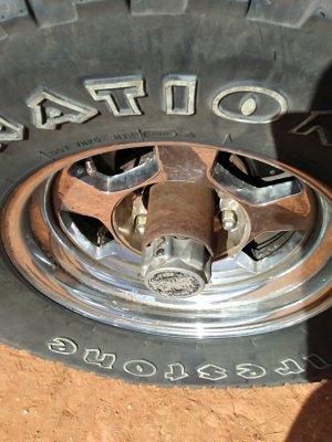

Dude it"s a '75 K5, unique-ness is what it does. Drop top hot rod smoke show in the making!

That pic is much more clear than the previous pic you posted. BUTTTT it looks to me like you may have a bastardized set of locking hubs on there. I say that because your wheel hubs do NOT appear to be external style hubs, but the locking hub cap looks like the selectro cap which belongs on an external style locking hub body. This may explain why they are not functioning properly. I may be wrong, but it just looks like something isn't right there. See if you can take one of the caps off and post a picture. That would help us see what's really going on there.

Were Selectros never made for internal hubs? I'm sure I've seen them on the bigger Dana 60's before, but maybe they were all Dodges. I think Dodge had an external type hub at some point.

I didn't find SELECTRO s for internal hubs while looking today, but I DID keep coming up with that 104#. I also see that Sears rebranded Selectros at some time, which are Mile Marker hubs! :D They are still sold as new externals.
From my very limited knowledge, I agree, they look "bastardized - like a combo internal and external hub which is cool, because it's easy to turn. They have been working properly for the last 6 months... Makes me want to to custom bastardize some new ones to say SELECTRO. :D
But if it ain't broke, I'm not gonna fix it. Tomorrow I'll try to take one apart maybe but it really does look like JB weld in that back rivet hole you're looking at. *gulp* On both sides! I think it'll be cold tomorrow? It was 74° today!

After some brief googling, it looks like those are internal locking hubs. At first glance they look like selectros (the selector cap is similar) which, best I can tell, were only available as an external locking hubs. I only recently learned about external hubs when I swapped a dodge Dana 60 under my burb. But the hubs on your truck appear to be the internal style. From what I can tell, the selectros have a plastic component inside the cap which actuates the gears inside the hub. That plastic piece is prone to failure. That may be what happened to yours. So you should be good to swap on a set of internal style locking hubs from warn or mile marker or other brands. But I would still pull the cap and verify the axle shaft spline count before ordering new hubs.
