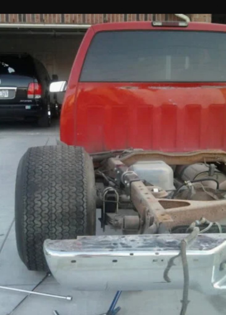

Or pick a wide enough rear wheel and tire and go phantom dually style.

Any recommendations wheel wise ? What should i get ? Do I still get the spacers for the back wheels ?
Among other things and as you’re just doing this for looks, realize the other truck you posted has a considerably narrower flatbed, made for srw narrower track width rear wheels.
There’s not a way to make it look like that truck without a new flatbed and new front hubs, etc.
Then worry about what kind of wheels and whether you want or need spacers.
