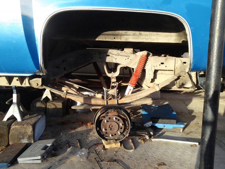

The88
Mhmm
Dec 9, 2015
1,074
1,363
South Louisiana
ThatGuy
88
This is how I set mine to keep the truck as low as possible and give me room to work. Single jack under the chunk, set jack stands high on blocks to remove the wheels. Once I popped those guys off bumped up the jack and lowered the stands, then lowered the jack back down onto the stands and voila. Railroad ties work wonders.

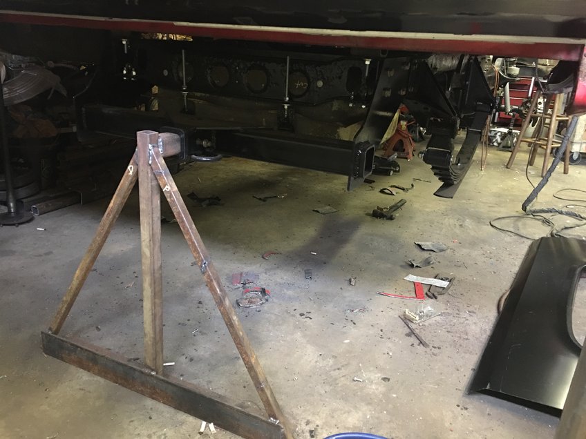

If you have a receiver hitch I made a stand that slides in mine. Then you can use small stands to hold the rear. I can post a pic if you want. Its nothing special though.
Sounds pretty cool, mind throwing up a pic?

Easily removed when the rear is back in. Just some scraps I had laying around
