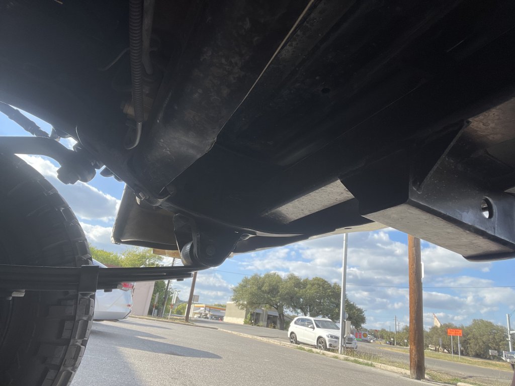

Look at the Steering shaft and see how worn the rag joint is. This design allows a lot of slop no matter if new or not. Check out this Jeep steering shaft hack. It replaces the Chevy shaft with a Jeeps shaft which has no rag joint. I am doing this now to my 78 Cheyenne 4x4.
I was told many years ago by an old man much smarter than I, not to remove the rag joint and install a u-joint. His reason is that the rag joint absorbs vibrations and movement from both the road and from the cab, to protect the bearings and gears in the steering box and in the column. Your cab is mounted on rubber bushings and moves around much more than you might think. Without the rag joint you are relying on the ball joint at the column to take this movement, not just side to side but in and out too. The rag joint also absorbs bump steer and vibrations from the road that can travel up the shaft. I don't know if this is true, and I would like to know if someone has done this mod on a truck that does hard 4-wheeling, and if they have felt any difference or had steering failures

Ideally, if removing a rubber isolator, you want the shaft to change lengths freely. Then there is no binding as the cab moves.
Removing the rag joint does indeed add in a noticeable amount of road feel, but that is a desired trait for many people.

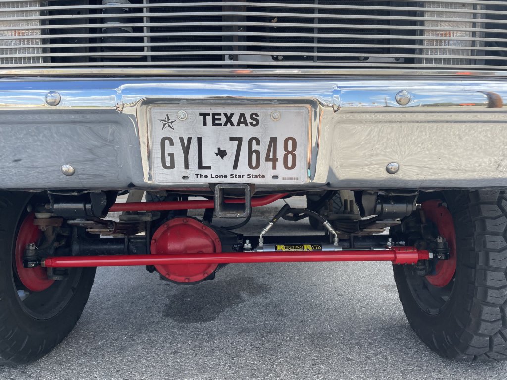

I have the Frame support and Crossover Steering with 4" lift and 33s. the ORD Crossover Steering fixed my looseness issues. Might have been going to the 2WD Steering Box which is required for Crossover Steering. I considered using the Jeep XJ Steeering Shaft as well. But once the Crossover upfit was complete the looseness went away.
