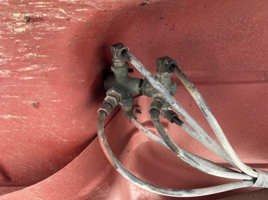

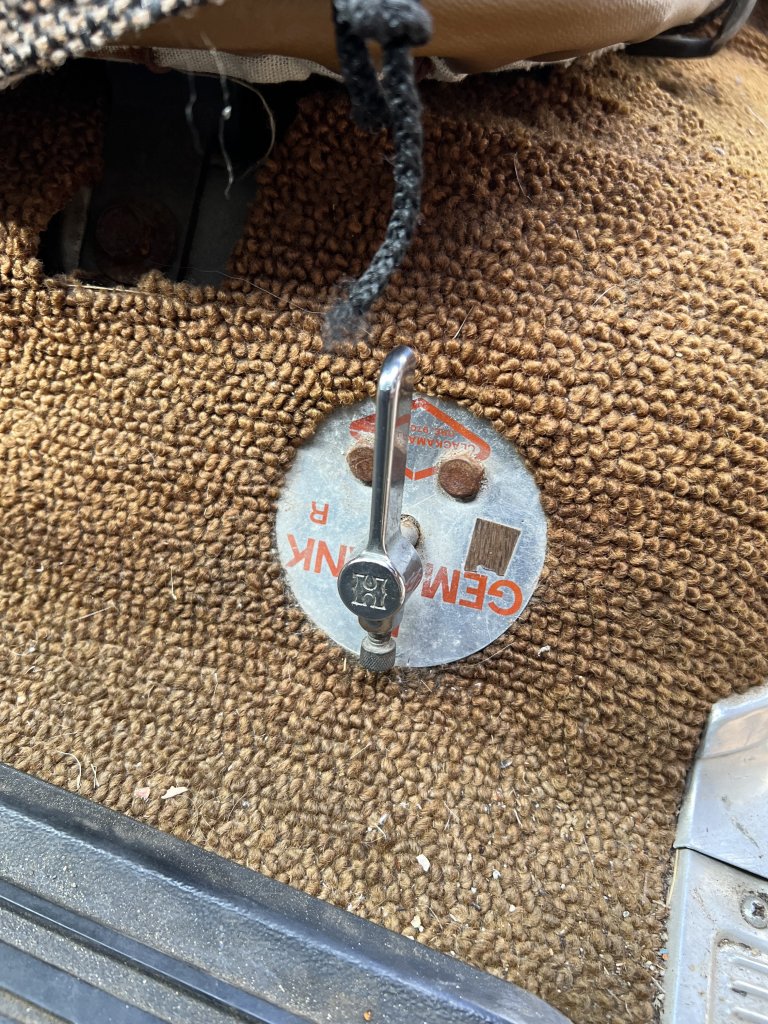

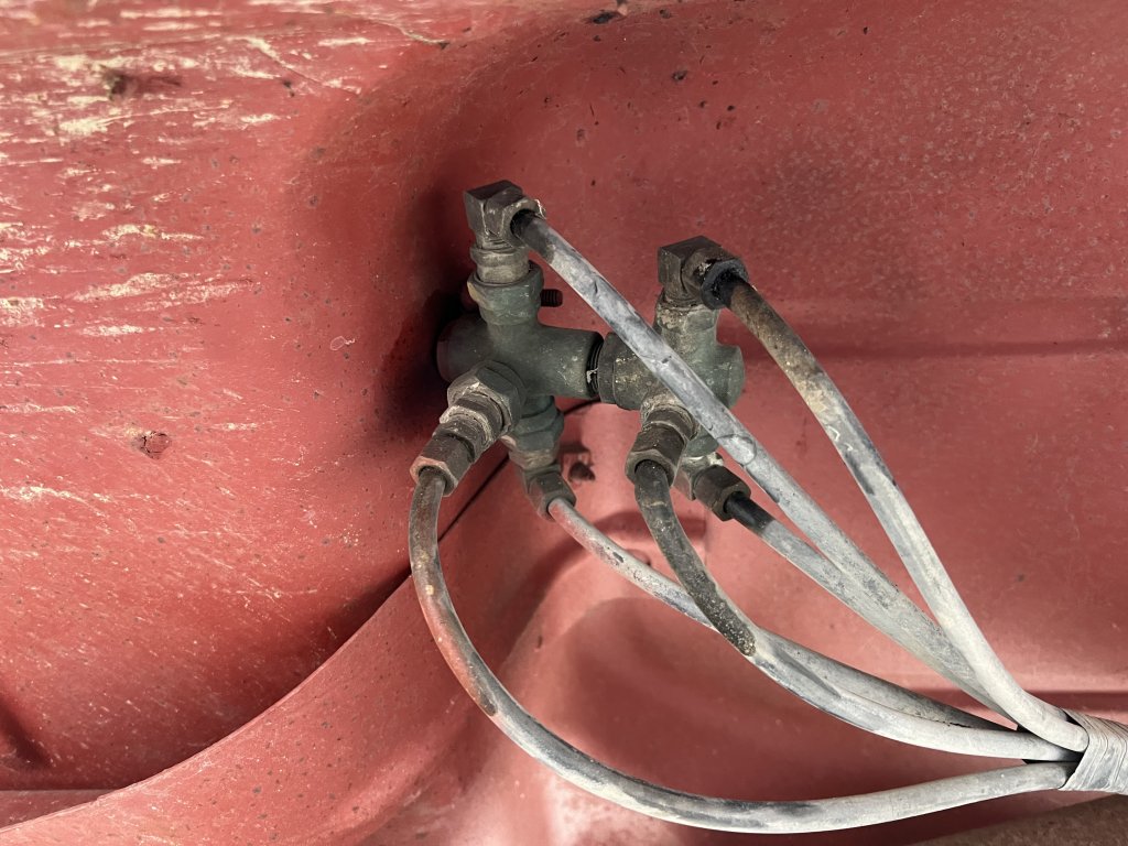

Here are all photos I took! Thanks for the reply! It’s like 1st owner deleted that (your right) drivers side option. Idk if R means right or reserve.

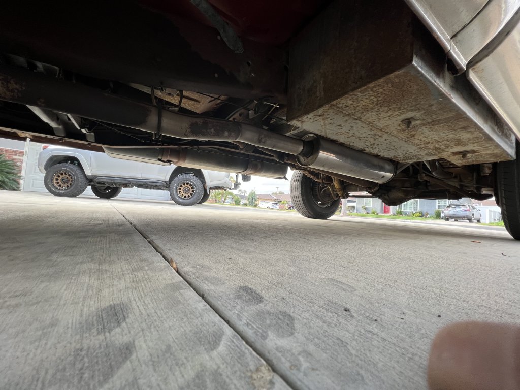

On another note…How big is that aftermarket tank?
Must be bigger than OE 20 gal tanks or why would anyone have gone through the trouble since the OE tanks are interchangeable and always have been.

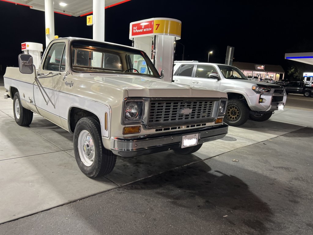

All great questions. Older man I bought it from didn’t know much. He bought it from his friend who owned it since he bought it new. Had the camper when he bought it but sold it to a different friend. Old man I bought it from bought it from first owner in 2018 and said he didn’t drive it so he got rid of it. I’m the third owner supposedly. Runs like a dream.

Gorgeous truck! My favorite nose too!

More great questions? The underside of the seat tub there looks unnaturally clean and shiny. And I’ve never seen a pink/red underside paint, unless was the truck originally red and repainted the current color.
Another question. 73 wouldn’t have had return line from the fuel pump originally. But that’s a 6 port valve so must have a return line?
That valve handle, has a knurled nut on the bottom. Is that a lock to prevent inadvertent switching? Or does it just hold the handle on? Have you loosened it?
Valve could just be stuck. Obviously it’s running off of the right side tank based on your post, even though it’s not pointing at “R”.

That red oxide color was the type of sealer they used in the 70's on trucks, K5's and Suburbans too.

looks like a push/pull stem rather than a twist left/right.

That auxiliary fuel tank looks like something added by a camper dealer. It was pretty common to add them to pickups when slide in campers were purchased to add more range. The ones I have seen set up that way did not have the fuel gauge hooked up, so the gauge only worked for the factory passenger side tank. Similar to when saddle tanks were added to old C50/60 grain trucks that had a factory cab tank behind the seat. Guys would run off the bigger aftermarket tank until they ran out and then would switch to the smaller factory tank as the "reserve". The valve may be hard to turn due to corrosion/rust. I would imagine either a 90 degree or 180 degree turn would switch it back to the factory tank. Might want to drain that factory tank if it hasn't been used in a long time. Who knows how old that gas might be! What does the driver's side fuel fill look like? '73 would have had the passenger side tank as the standard tank and the drivers side would have been optional I believe.
