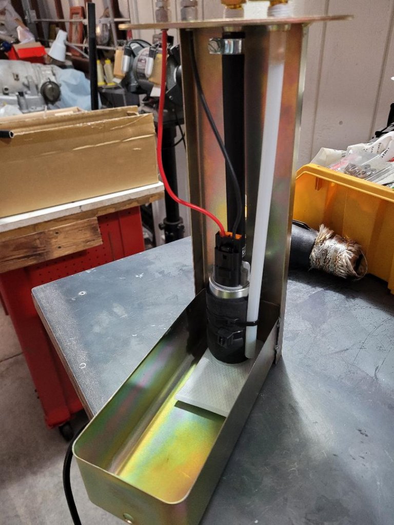

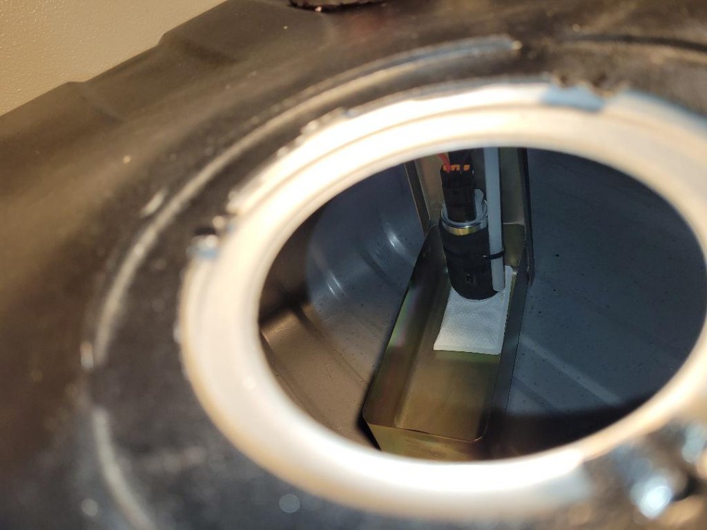

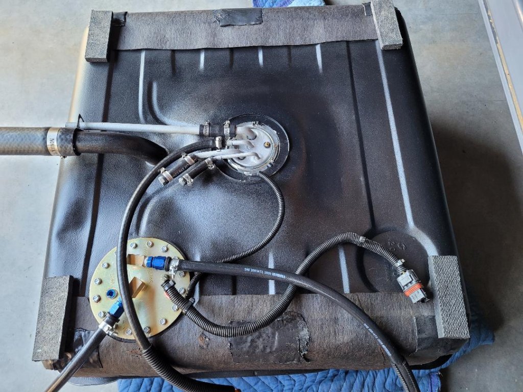

If it helps, I have a 75 blazer, currently with quadrajet, but plumbed it efi ready using stock tank (31 gal) and Tanks Inc retro fit pump with tray (PA-4) and extra thick gasket (6G-F). Works great. No noise, starvation or cavitation issues. Some pics attached.
Plumbed with Gates Greenshield and braided teflon hose at flex points, and hard line along frame, AN fittings etc. Using relay and #10 wire for power, and weatherpack at the tank for easy removal. Currently have a bypass reg for carb but have a Holley Stealthram that I may go with in the near future. I kept the OEM sender in the stock location and used it for the vent and return. Hope this helps.

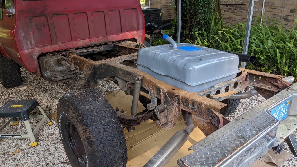

Ended up with the 31gal TBI tank from the blazer which apparently fits in the frame.. I know others have done it, but was still expecting the worst.
Holley sniper and their sniper retrofit in-tank pump for the blazer tank are coming..
Still need to pickup fuel lines hard and soft. Also need Holley to ship that hardware... that'd be nice.
Other half of this project is replacing all the brake hardware. So all new hard lines (the LMC box showed up in one piece so that's a good sign), master/booster... actually hooking up the rear brakes since the lines were snapped and the proportioning valve is apparently seized.
Also pretty sure the brake fluid is from the late jurassic period..
So project "make it start when i tell it to, and stop in general" has started..
now to start thinking about how to route the filler neck up to the stock fuel door in front of the rear tire on the driver side.. well that a whole mess of other labor-intensive work... something about cutting frame supports so that tank actually squeezes down in there. Gonna throw a beer at it and see what happens.

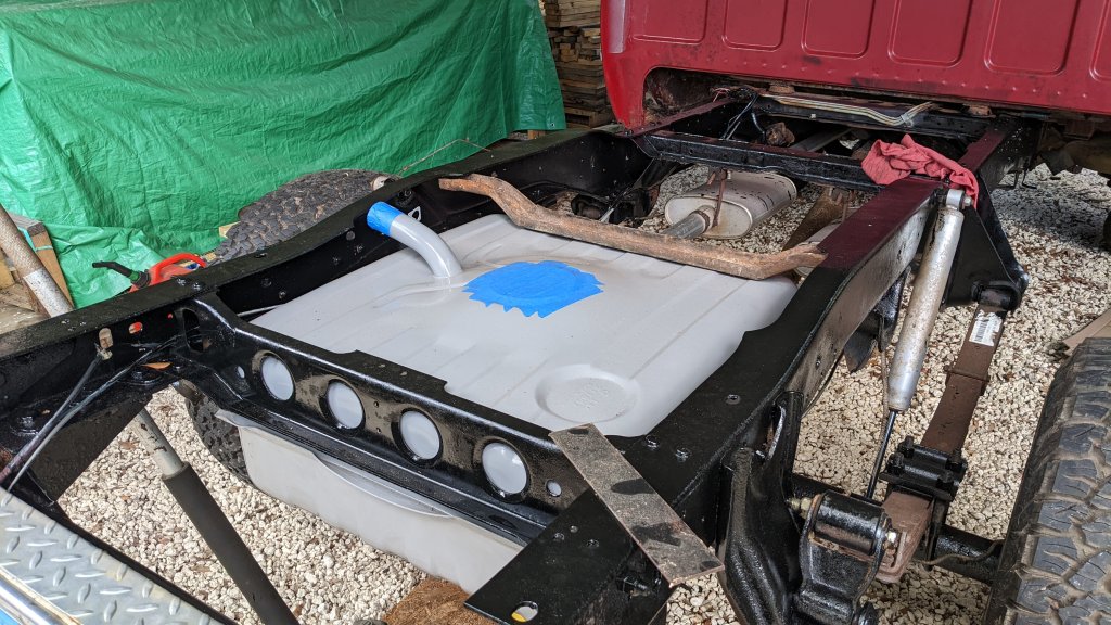

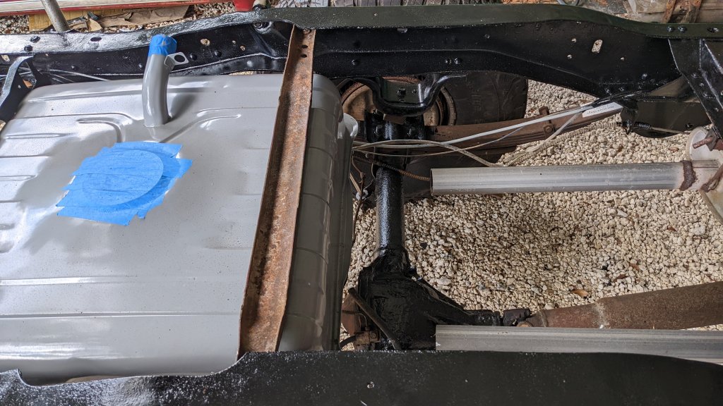

Making some progress. Waiting on some paint to dry on the frame supports that have been moved and some rain to stop so I can get underneath it and drill up through to bolt down the angle steel for the straps.
Started looking into the fuel line options and have decided to go with ss hardline and replace all the factory stuff since it stops so short.
Looking for recommendations on tooling to bend/connect the SS hardline as well as PTFE tooling for the ends. - that's a whole new world for me so I'm starting from scratch.
Second pic shows the lack of clearance longitudinally of for the rear end to come up and make holes in the tank. Got a solid 5.5-6" vertically between the two and a renewed need for longer bump stops anyways since the 4" spring lift on it negates the current stockers.
Second pic also shows the brilliance of my painting abilities. I'm here all week.
