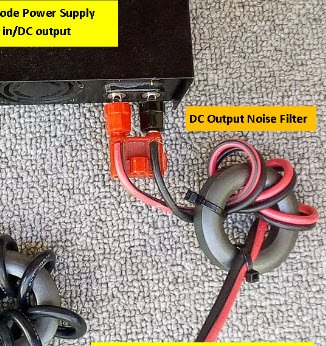

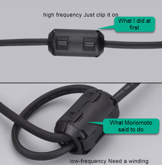

So I bit the bullet and put the LED headlights in- and they are great! BUT they also totally kill the FM radio. Tried just sticking these ferrite cores (https://www.amazon.com/dp/B08DC9JF5K/) on the leads, but no joy. Called Morrimoto who makes Retrobrights for Holley and they said I need to loop the wires through the core- I wasn't clear on how they would do that with a 1/4 inch ID snap-on core, so will call back. Wondered if anyone has anypics of a proven solution that they've used or if anyone tried using the larger doughnuts like one might do for ham radio- like wrapping the leads around these 55 mm doughnuts https://www.amazon.com/dp/B07PDMWN57/ since the plugs will pass.

snap on ferrites are about 1/10 as effective as a single torroid with 10 'turns' through it.
to further complicate, the 'mix' of the ferrite determines the frequency range it is most effective at.
you'll want a mix 31 or 43 for common mode suppression up to 300mHz.
on the power AND the antenna coax.
as others have mentioned, some 'makers' suppress the rfi better than others.
basically, if everyone driving used only broadcast radio, the makers would feel pressure to not interfere.
i run amateur radio in the hemi ram and rfi is a pain in the butt to get rid of.

You could also add a ferrite to the power/ground wires to your radio. Help suppress the noise there also.

Bought a selection of cores- still waiting for a few. BUT after I clipped just one of these on a looped section of drivers side harness the radio worked- will post pics once I have it licked
