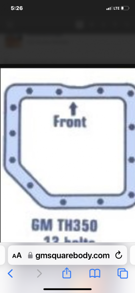

Thanks I will have to try to figure out what kind of transmission
Look at the pan. Compare to this chart of pan shapes.

Hi it’s this one . Now I’m under it I see it’s been leaking pretty good.
