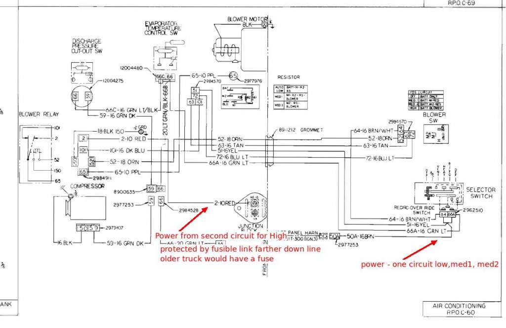

The lower blower speeds go through the resistor pack, and the high speed is a direct connect through a separate fuse. The separate high speed fuse is in a wire that runs across the top of the firewall from the junction next to the brake booster over to the blower relay. My ‘75 GMC kept frying the fuse holder, so I spliced in a new fuse holder with a blade fuse. It’s been fine since then.
