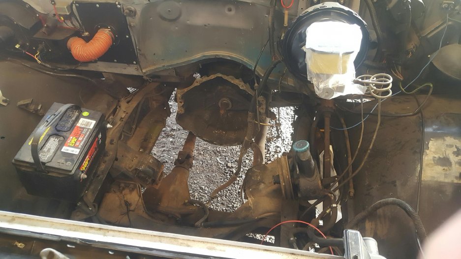

when did mine I just took it all out and
rebuilt the firewall to a non AC firewall I made the new firewall it out of
18 gage steel sheet
Here is a before and after pics sorry there not that great
