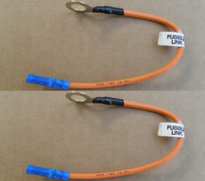

Still gonna replace those old fusible links near the starter, cause their connections look pretty bad. Found some NOS ones on ebay:
Not exactly the plastic cylinders but they'll do.
