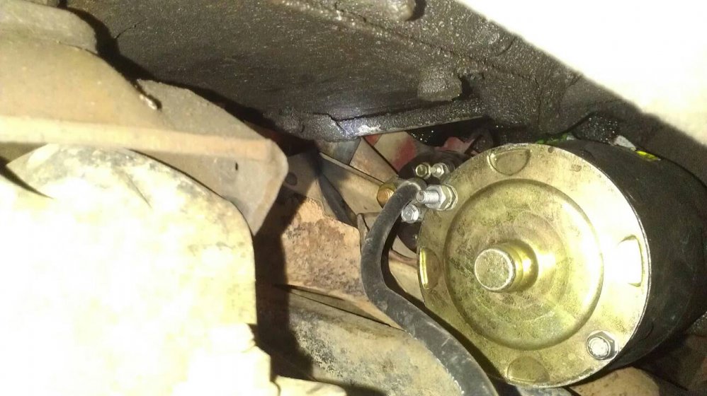

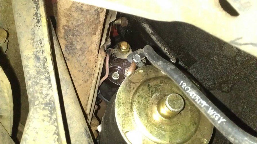

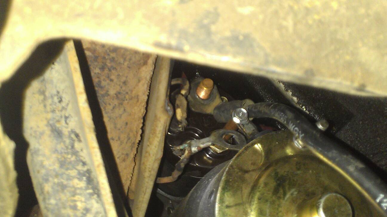

Here's an update with some pics. I went back to the source: the starter. I know what you're thinking...genius! How did he do it?
What I found was a melted, burned through wire from the solenoid. The yellow and pink one go to the same connector. The yellow one was melted and burned through. You can see black burn marks on the exhaust shield in one pic. Didn't have the connector to fix it tonight, bit It's a good start
