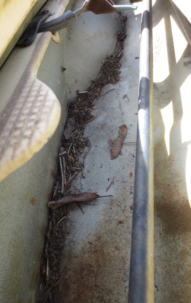

If you pull the kick panels off, along with the cowl screen, that gives access into the vent buckets.
I’d recommend getting/using a 2 component seam sealer.
This from Eastwood is decent stuff, just be careful where you are spraying (easy to shoot it everywhere if not careful):
SEM sells a cavity wax that has a spray tube as well. Might be good after sealing.

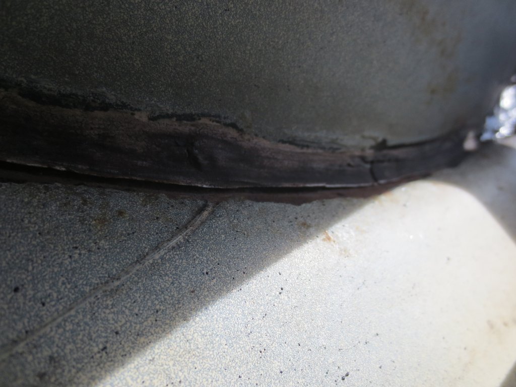

When I cleaned mine out with a vacuum, there was only light surface rust left. I had no actual rusted out areas or open seams. I did remove some small areas of cracked sealant, but I was pleased that it looked pretty good after all the cleaning, degreasing, and spraying in the Permatex rubber goo. Even the chemical smell dissipated after a few days. Haven't seen water on the floor of the cab since.

Couple more pictures from the Blazer.
Got worse before it got better
Donor metal being welded in
"New" vent buckets and original cowl/booster reinforcement all reinstalled.
