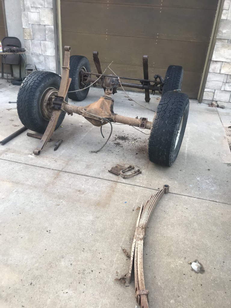

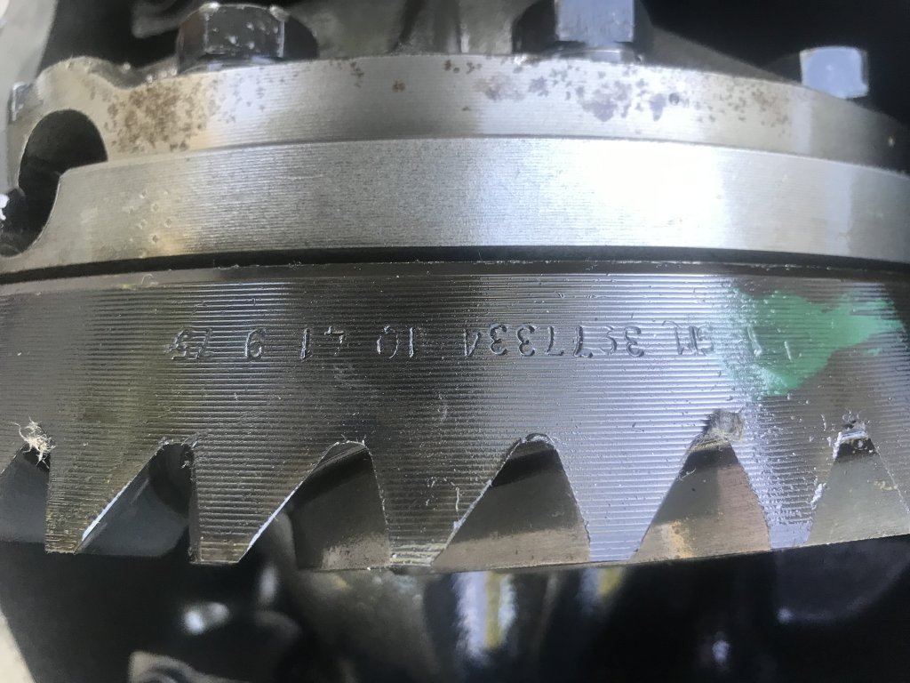

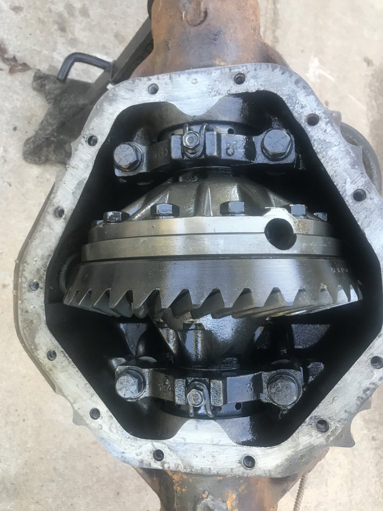

So I have a 75 suburban with a dana 44 an 14 bolt ff. I thought the gear ratio was marked on the gears?
They are... the 10 41 is telling you that you have a 10 tooth pinion and 41 tooth ring gear, for a 4.10 gear ratio. The front ring gear will have similar markings to tell you what that ratio is.

Perfect i guess I i was making it to difficult. Im also thinking this is a non locking 14bolt ?
