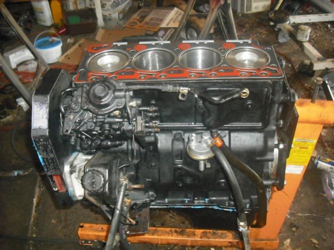

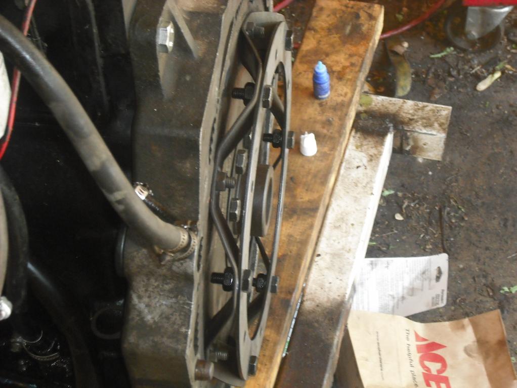

The cummins engine does not have a molded in surface in the block like what you're use to seeing in most gas/diesel engines that mates the drivetrain. That's how they put them in everything from generators to bulldozers to highway applications. I fairly certain that the nv4500 and the 47rh/re use the same adapter, but I could be wrong. I am sure it's easy enough to find out, but there is an adapter there. I attached a couple of pictures of my engine. One is with the adapter off and the other was the chevy adapter I had on it. It just simply unbolts. Here is a great resource on the cummins engine. http://www.4btswaps.com/forum/showt...ex-BOOKMARK-THIS-THREAD-FOR-FUTURE-REFERENCES
You may say that it pertains to the 4bt, but this engine is to the 6bt what the 4.3v6 is to the 350. If you ever think about installing these cummins into a half ton just remember that the 4bt is about 800 lbs dry as the 6bt is about 1200.
So they are designed to be adapted then. Cool !!!
Damn, 200 lbs per cylinder. Pretty heavy motor there.
