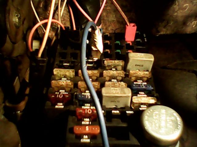

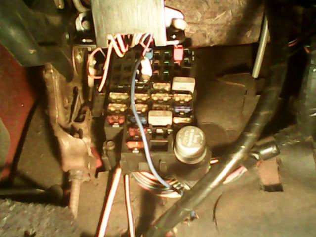

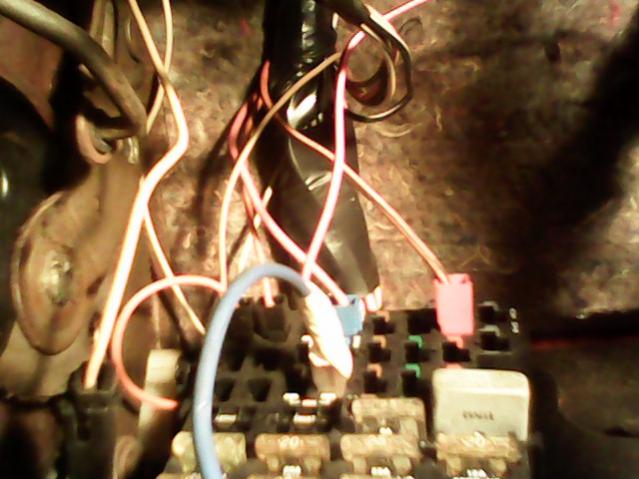

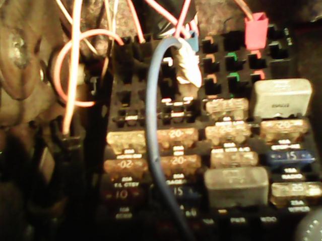

ok i fount the wire it is blue wire with tape on it not sure what it is tapped into but here some pics

so i took the blue wire out it was just taped with the ignition wire and stuck in the little ignition port but the ingition wire is fine wasnt cut or anything so still stumped on this service engine light i try unhook positive battery cable for 5 minutes turn key on still stays on unhooking battery shouldve reset am i right?

It will stay on with key on engine stopped. Once engine is running it should go out.
