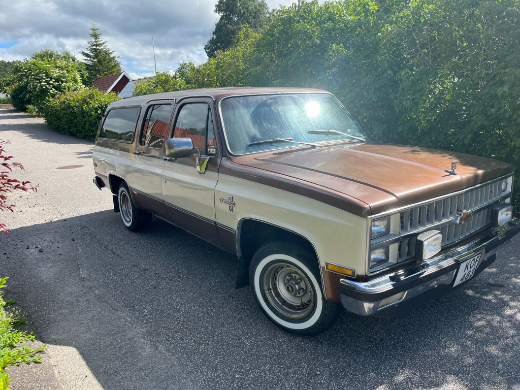

Hej community !
I have a stock C10 Burb with a 350 engine and auto (not sure which version) from 82 rather new edelbrock carb fitted and runs well, what type of mpg should this set up be expected ?
Recently did a trip from mid of Sweden (Gothenburg area) down to the Nederland approx. 1200 km (745 miles ish) one way mostly freeways and "normal" roads, i sort of end up at 1,6 - 1,7 L/km (13-14 mpg) would that consider to be "normal" ?.
And of course the tread shall consist of pics :)
