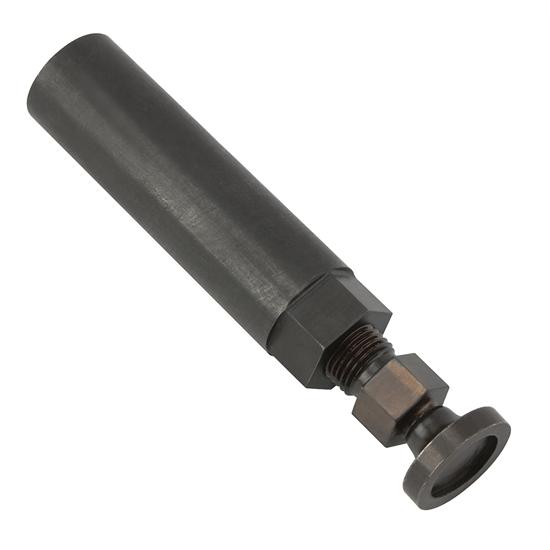

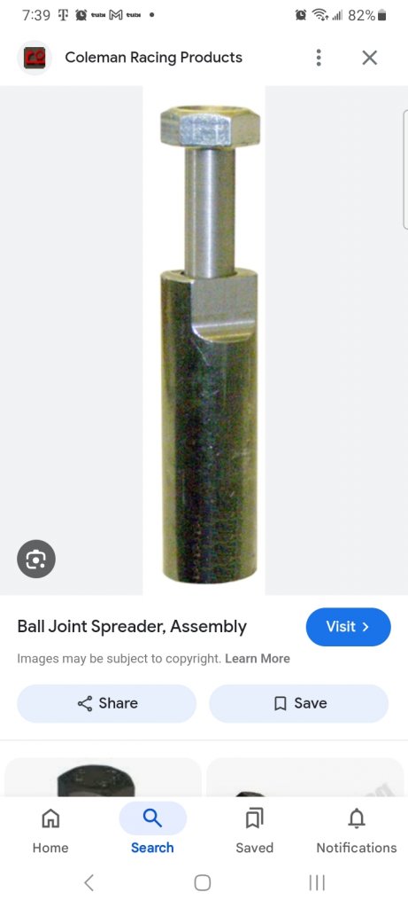

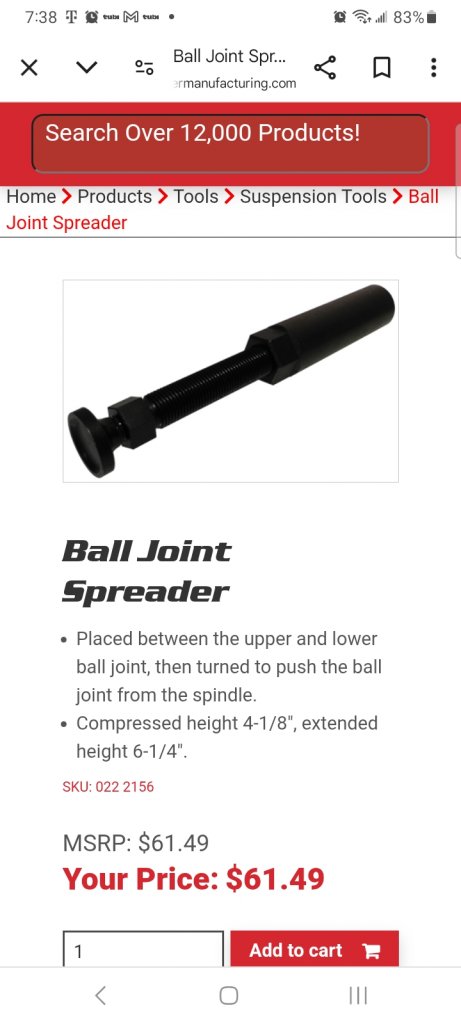

This is what I was telling you how to make out of 2 bolts and a coupling nut.
