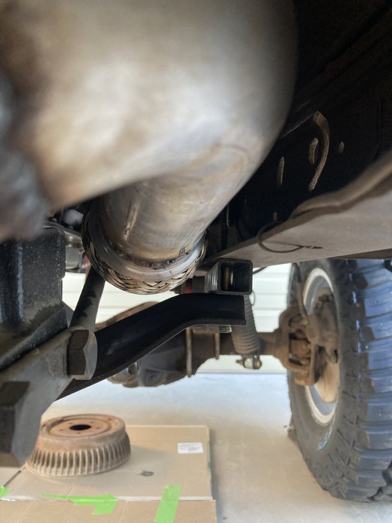

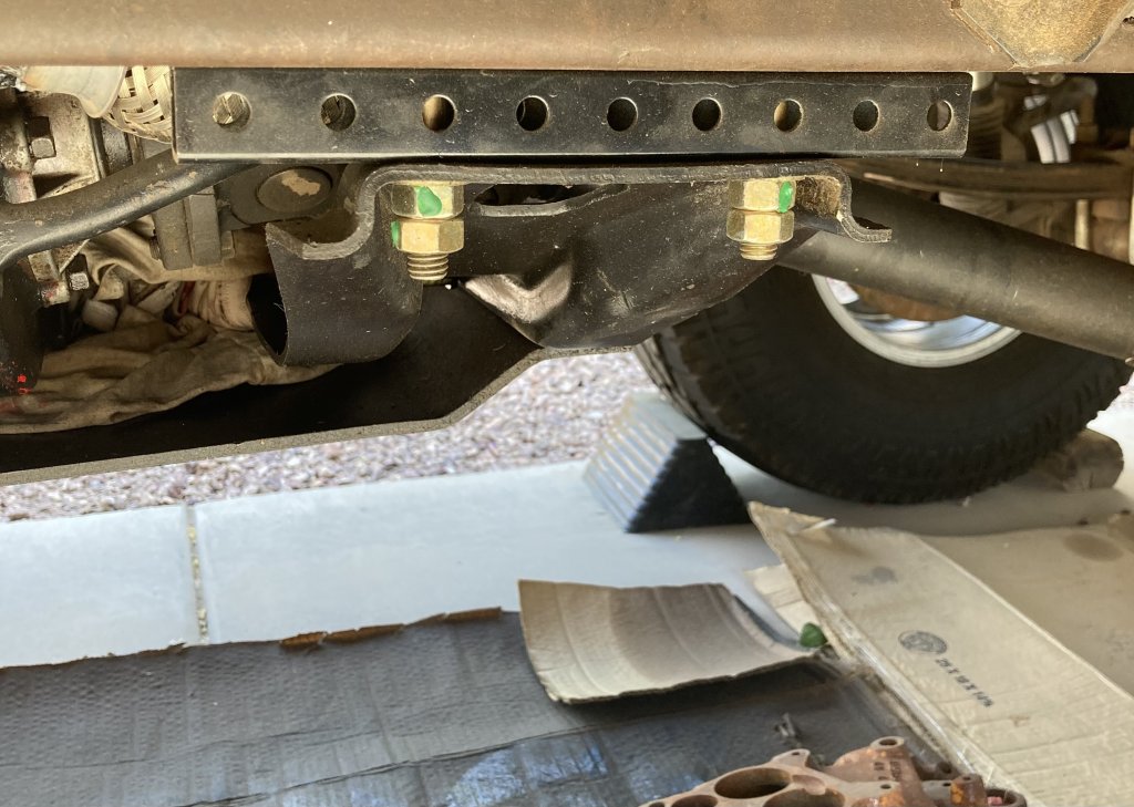

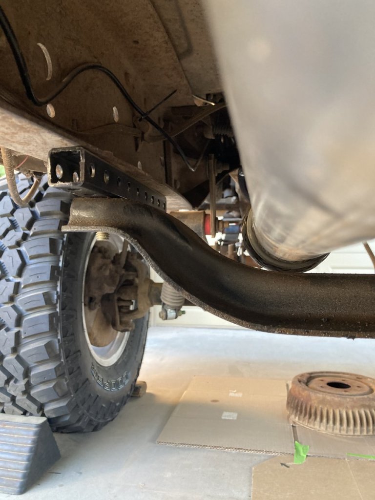

I have this issue. I want to get my 203 back to stock placement. But my exhaust runs right were I need the crossmember to get flush with the frame. I guess I could dent the exhaust pipe but. This sucks because I've done the exhaust twice and explicitly told them to get the pipe inside the frame rail, and they failed. Anyway, a third time is coming.
I have a 205 going in to replace the 203 eventually, so I'm just running it as is for now.
Also if you keep the Tcase dropped you may think about spreading the weight better and getting a better clamping area.
I did this, as suggested by some people elsewhere. Yes I should have the bolts going the other way, but I don't wheel often enough to flip them.
