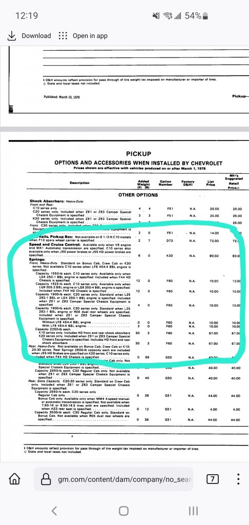

I actually put a 6 cylinder spring on my stock 350 1/2 ton.
I cut a coil off of it as well. I can't remember the spring rate differences. GM's heritage site may have the info.
