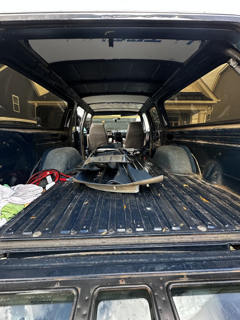

I’m trying to do one in my 86 suburban and I haven’t had much luck with headliners in the past. I was thinking about getting some really thin wood from Home Depot and creating the panels that way.
Do you have any suggestions for ways to do a headliner in this and what glue to use? I have never had good experience with glue on wood panels and most of my headliners have fallen down using either the 3M spray or the gorilla glue adhesive spray.
Maybe it’s because of how much heat hits that headliner. I’m not sure, but I just haven’t had much luck.
I'e used both 3m and Gorilla with no issues. Biggest thing with them is to make sure everyting is clean and dry. Spray both pieces and wait as directed (usually abut 5 mins) so both sides are tacky - this makes them stick together like crazy.
As far as building the backing, I've not had to do that part. The several I have built all had good bones but the material was falling.
