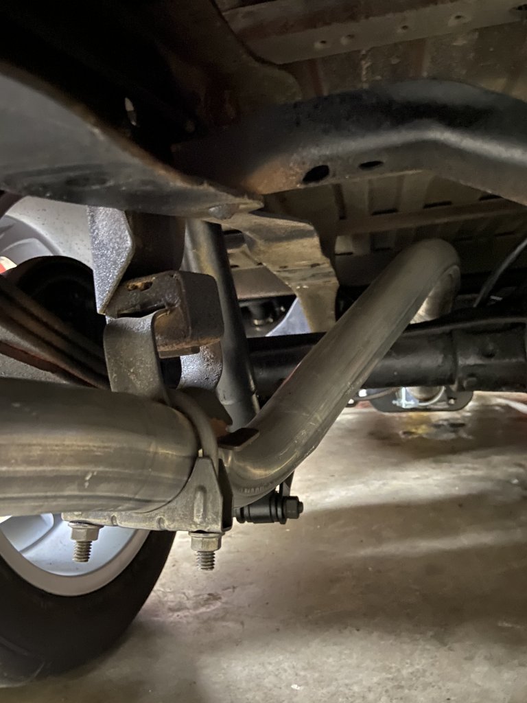

No need to do a C-Notch if your doing a flip kit! I still have 6” of clearance.

This is correct. If you go lower than just a flip OR if you still plan on loading the bed down you might need to start lookin into it.

Gotta pull that bumpstop bracket though for sure! I'd add a low profile bumpstop just in case you do manage to bottom it out.
