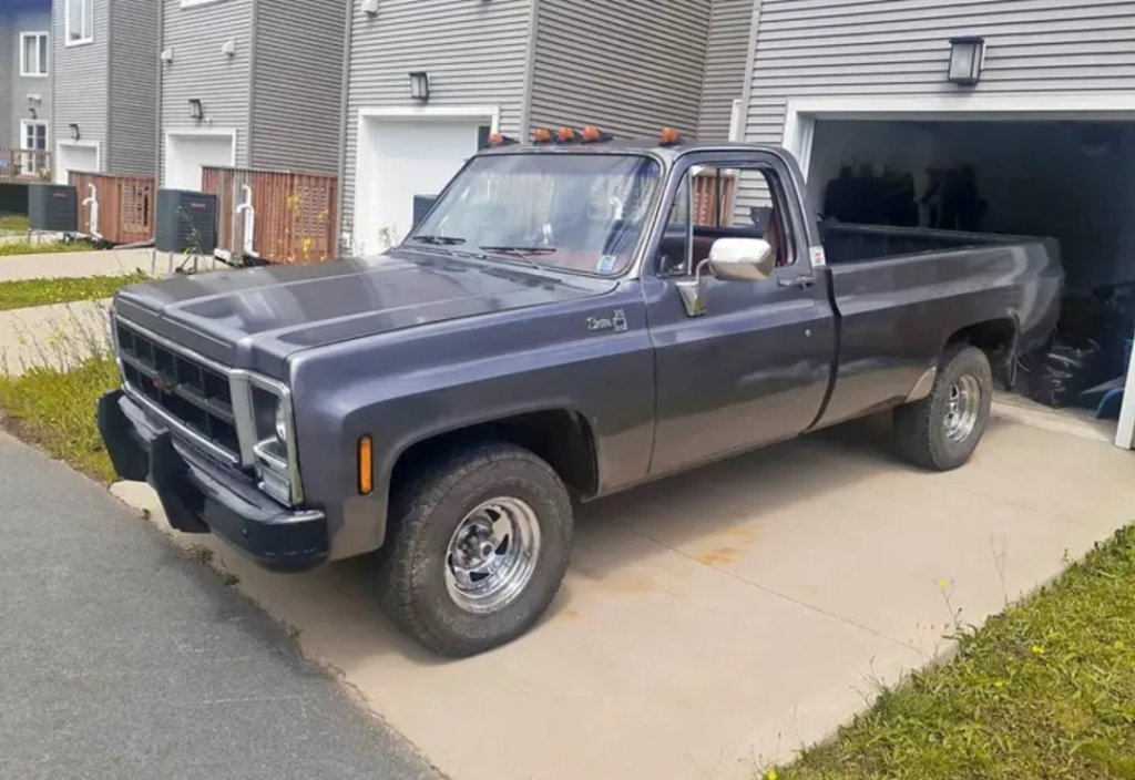

Hey folks,
Recently picked up a 1980 GMC 1500. Drove it home (4 hours) and no issues. Since then I noticed that at night my headlights are flickering. The lights seem nice and bright until I start driving, then they fade a bit and flicker. In addition to all of that my dash lights seen super dull and nearly impossible to see. Seems like there's a draw or something that is straining the system. Any ideas on where to start?
