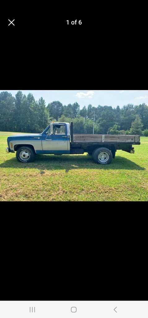

I wanted to know what's needed to change this flatbed truck to a truck bed? Owner says its a camper special I didn't know they made the camper special with a flatbed

Welcome to the forum. Most likely that truck was built with a dually bed. The big issue would be the cost of the bed. With the outer fenders not damaged, they are rare. Regular 8 foot bed could be used but that still leaves you needing the outer fenders.

To the best of my knowledge there are no repops of these fenders which makes me super paranoid about mine and keeping my mint! I would be pissed if anything ever happened to them LOL

For quite a while there was a company making them, along with dually conversion kits. I have no idea if they still make them though. I can't even remember the name of the company. Arrow something or other.
If the truck has a 131.5" wheelbase, it was born with a truck type bed.

I ran duely bud wheels for a few years on a K20. Simple painted roof flashing screwed to the fender lips looked great as extended fenders.
