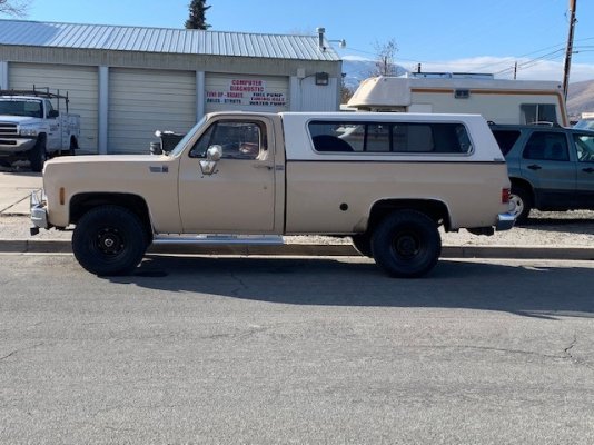

Thanks for the response. Yes I am looking for duel exhaust. The truck has a 350 in it and the current exhaust is pretty rusted from the truck sitting for years. Sounds like I am better off going with the 2.5 inch exhaust that is sold pretty much everywhere.
6,932
12,152
Wow! That truck looks beautiful! Original paint? Rock guards look OE still. ..
Yes if it’s a stock 350 and you don’t have plans for big power, 2.5” will fit the bill 100%.

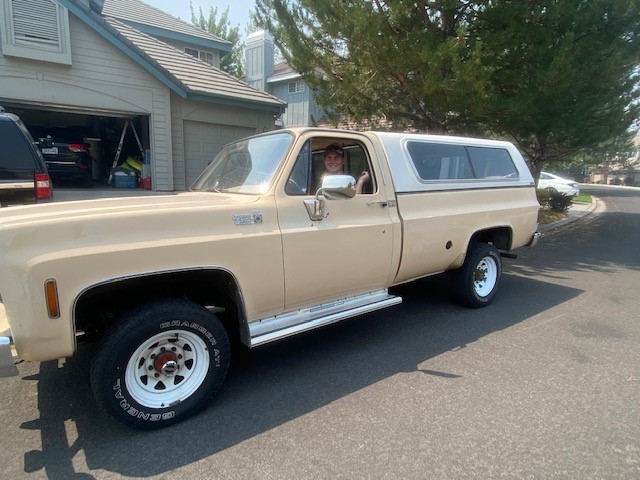

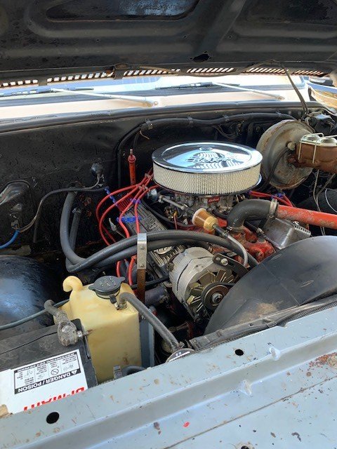

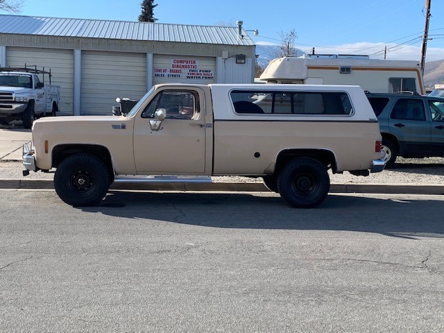

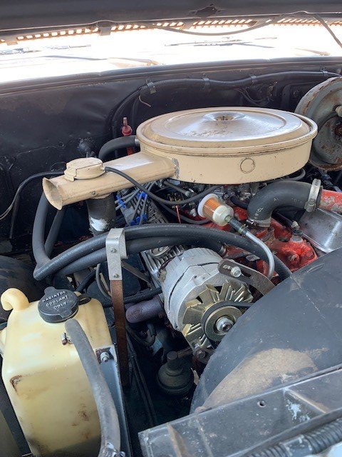

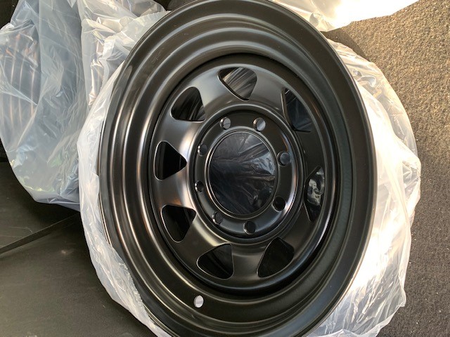

Yes original paint. It was an Oregon truck that I purchased from a guy that inherited it and did not drive it in Nevada. The rock guards are OE. We took the rims and powder coated them black and have been going through the engine. New radiator, rebuilt the carb, new plugs, wires, 32 inch tires, and some chassis paint. My son is driving it as a daily driver right now for the winter until the weather breaks. Super clean with very little rust on the bottom of the passenger side front fender. Bed has had a mat in it since original and no rust there either.

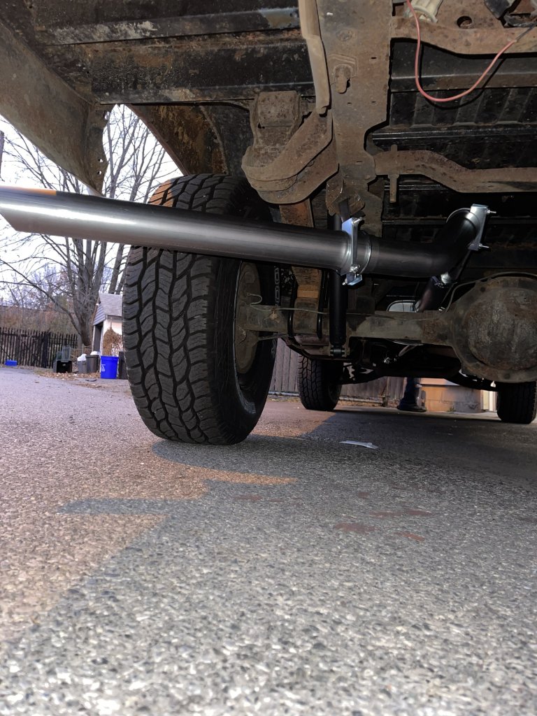

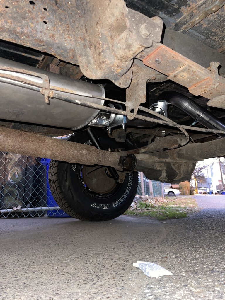

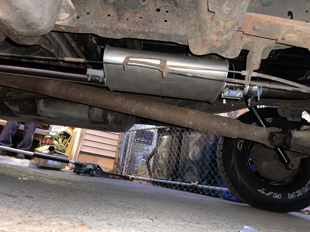

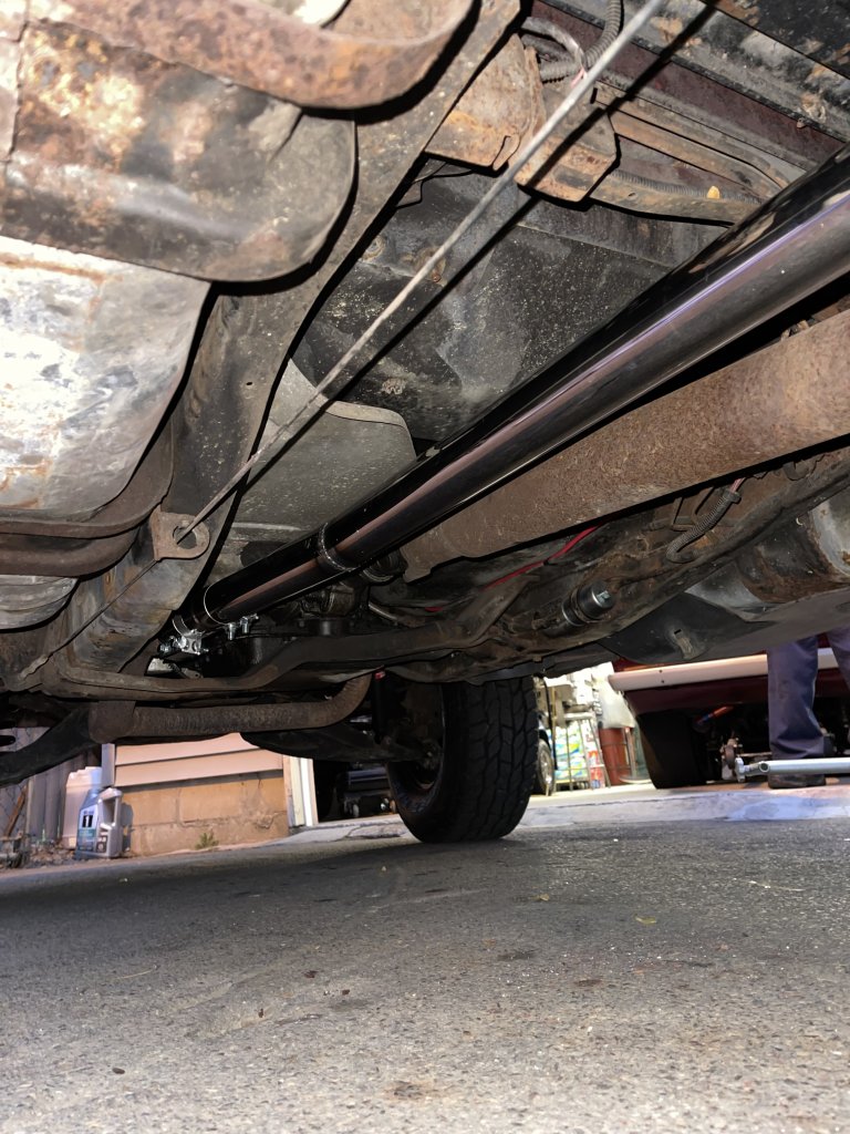

305. 2.5 all the way. Summit muffler
