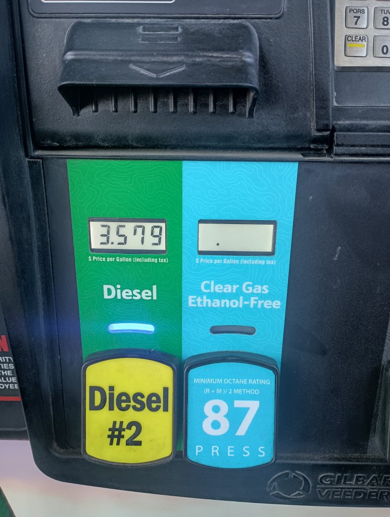

This e0 just started showing up recently. Going by the name Clear Gas.
