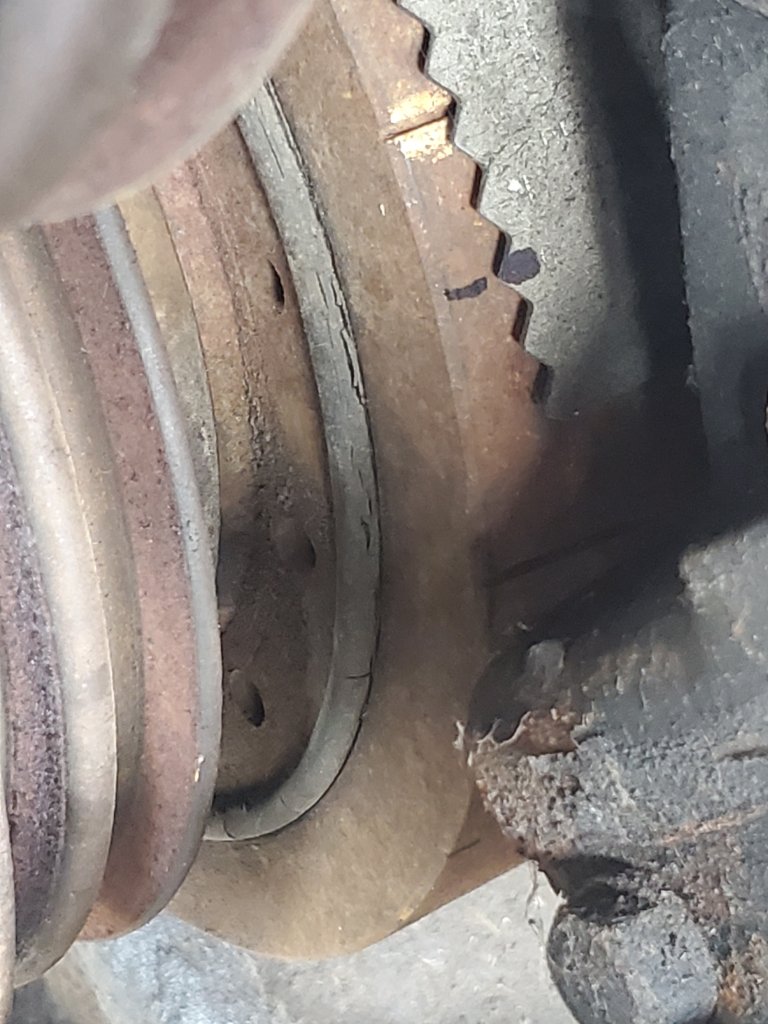

New information! Decided to check my foundation and used a piston stop to check tdc. In the picture the nicely outlined etched line at top if what I was using for timing. The two black sharpie marks are the two piston stop points and between them is a barely etched line that is closer to actual tdc though it's nearer the top sharpie mark. Plan is to make a new timing mark and then time the engine from there.

IIWY, I'd replace the harmonic balancer before I started messing with the timing. That thing is TOAST!

yea, looks like a good idea to replace it.

Seems good advice. One of those projects where the problem keeps going one layer deeper! But I already have the fan off to get to the crank so it's not that much further to get to the damper, just drop the $70 and borrow the tool from Autozone. Then make a good timing mark. Then tune up the distributor w new cap rotor and wires. Then set the timing!
