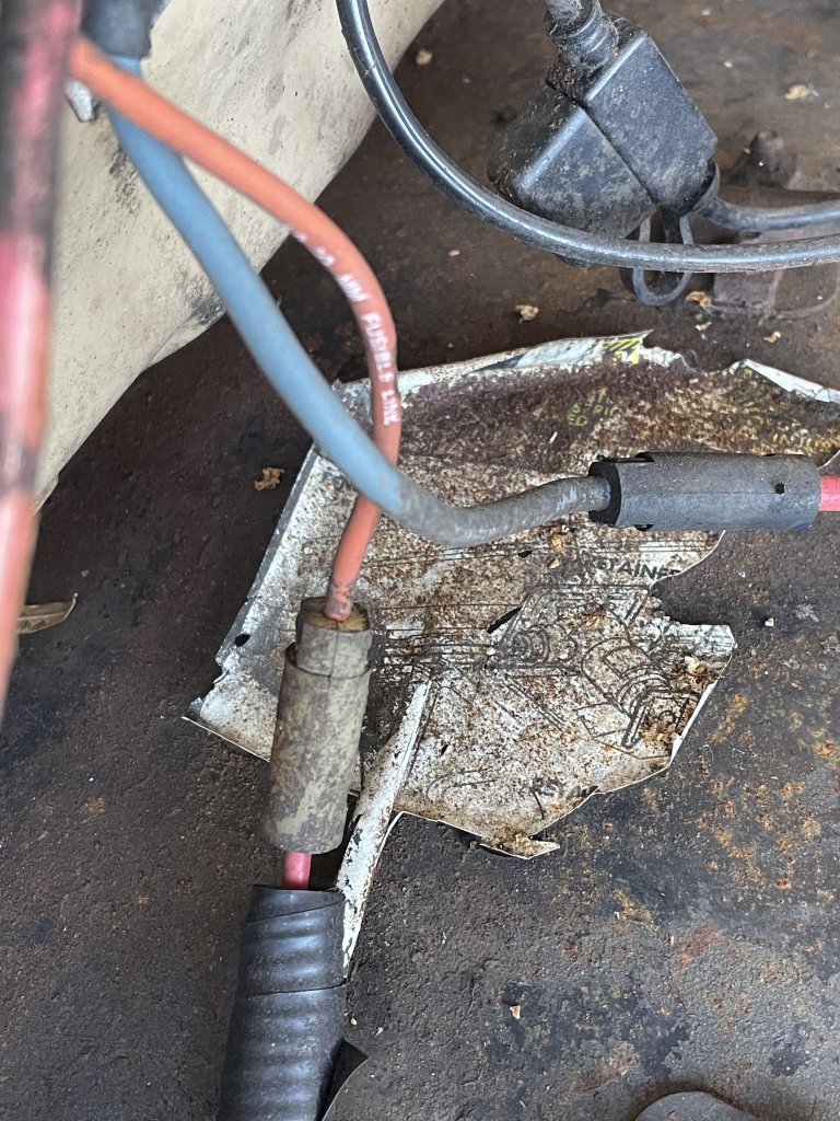

Is this a fusible link?

They don't put fusible links in wiring loom to keep them from melting other wires. The junction block on the firewall should have at least one fusible like attached to it.
Do you have a test light to test with?

I have a meter. I may have put that in wire loom years ago to “enhance looks.” I believe that was the only wire in the loom. Is that typically what they look like?

If you are talking about the vertical, thicker black wire in the center of the picture, with the dirty connector, with the bare wire sticking out of the top of the connector, no, from what I can see in the picture, that is not a fusible link. The red wire in the upper left corner of the picture looks like it could be one of the fusible links. Fusible links will be labeled in some way, either with the value printed on the wire or with some kind of "flag" that designates the value of the fuse. See examples below.
If you are talking about the terminal on the firewall with the red wire going into the split loom, you are in the right area. Do you know how to follow the voltage with your meter from the battery, to the starter, then to the junction on the firewall, then into the fuse panel inside the truck? Do you have the correct wiring diagram to follow.

Yeah sorry about that, this is my first encounter with fusible links. I’ve been researching them and a lot of other posts on this forum. Not sure what that disconnected wire with that “fancy” connector is but I’ll figure it out. Thank you for the pictures and the information.

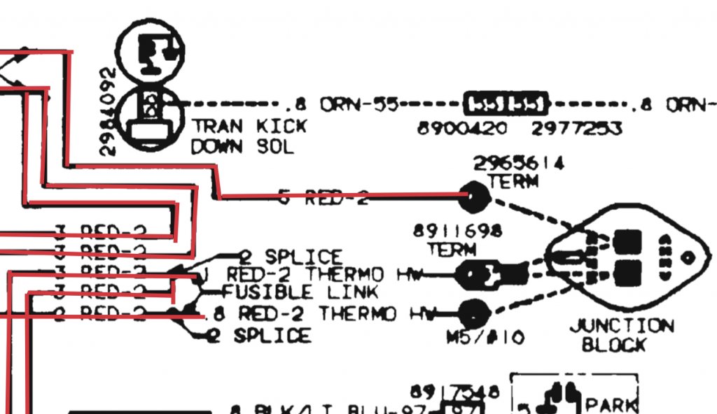

This is what I found. I checked all voltage from the starter, the alternator, the terminal block, and double checked the hot terminals on the ignition switch. I have voltage to all but the ignition switch. I rang out the wire from the terminal block to the ignition switch (the burnt one that I posted a picture of previously). The wire rang out.
It appears this has happened in the past and the previous owner spliced into the fusible link. However the link wire melted, not leaving much to work with. Does anyone know the size of the fusible link in this location? This wire comes off the junction block and splices into the 3 RED 2 wires that go to the ignition switch. The wiring diagram says M5/#10, but idk what that is relating too.

I found some fusible link wire at LS wiring. I couldn’t confirm before ordering so I got 10-18 gauge wiring. The wire I posted (earlier in the thread) was the culprit and is a 16 gauge fusible link. Its fixed and all power has been restored to the dash, tank selector switch, ignition switch, etc. Thank you all for helping me.
