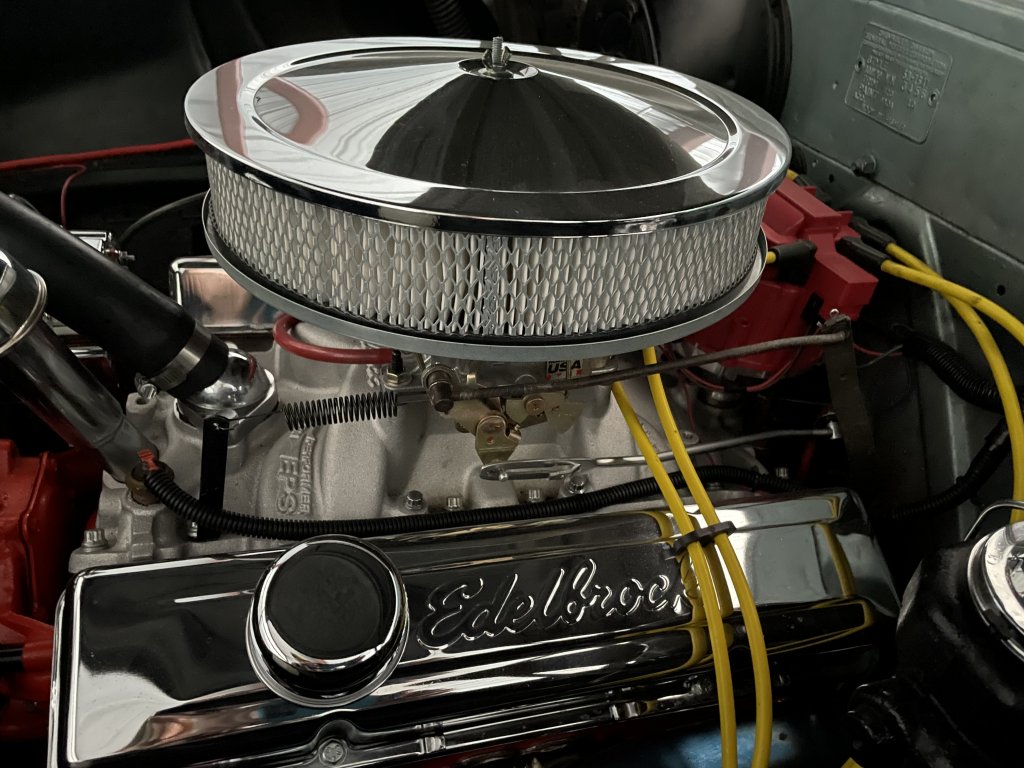

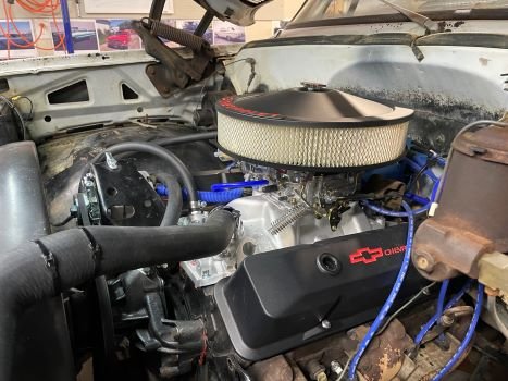

I have replaced the quad on 4 different 350 Square Bodies and a 1958 Chevy, 283 with the Edelbrock 1406. On 3 of them I used the Edelbrock adapter plate and on the others, I used an EDB intake manifold. I will use the adaptor plate from now on as it works great is easy to use and costs less (buy 100s) than a new intake. Super easy carb to get set up and once done I have never had a problem with any of them. For the most part they have been good right out of the box. (I am not building race car engines)
