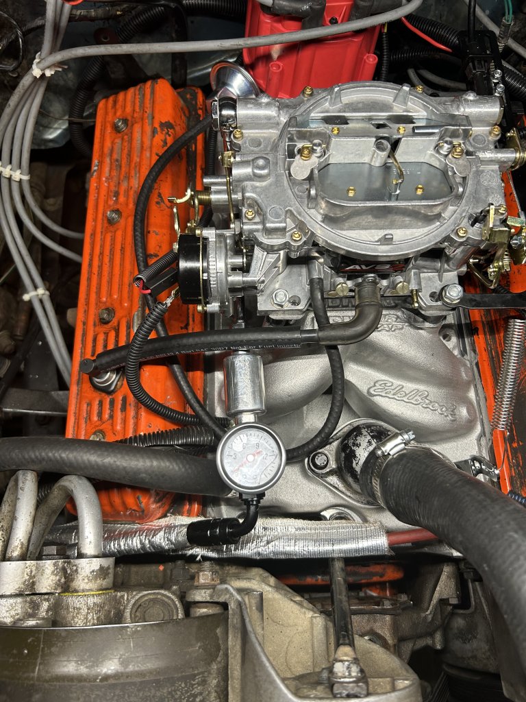

I have a 89 suburban i converted it over to carbureted it starts fine when cold even at 0F outside but if it sits longer then 10-15 minutes i have to press the pedal down as i am cranking is this normal?

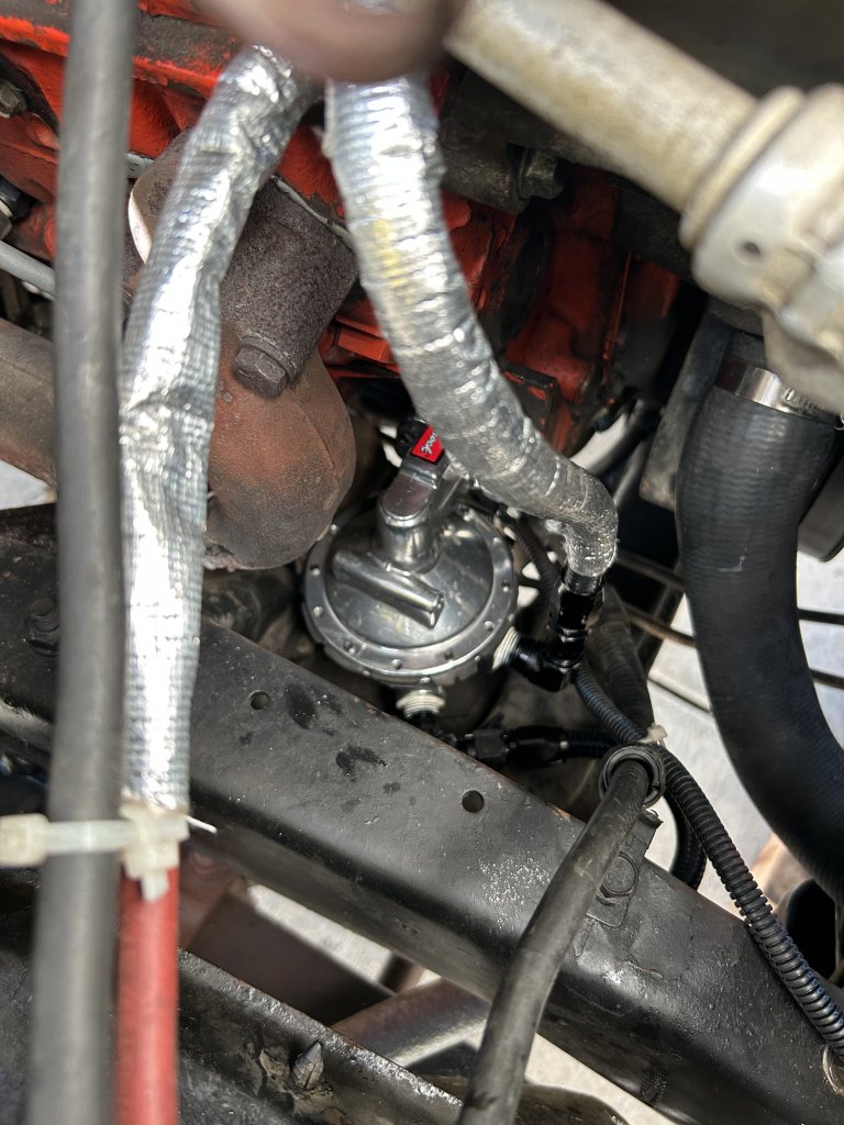

eldebrock 6psi fuel pump with gauge at outlet to confirm its 6psi
eldebrock phenolic spacer
eldebrock air gap

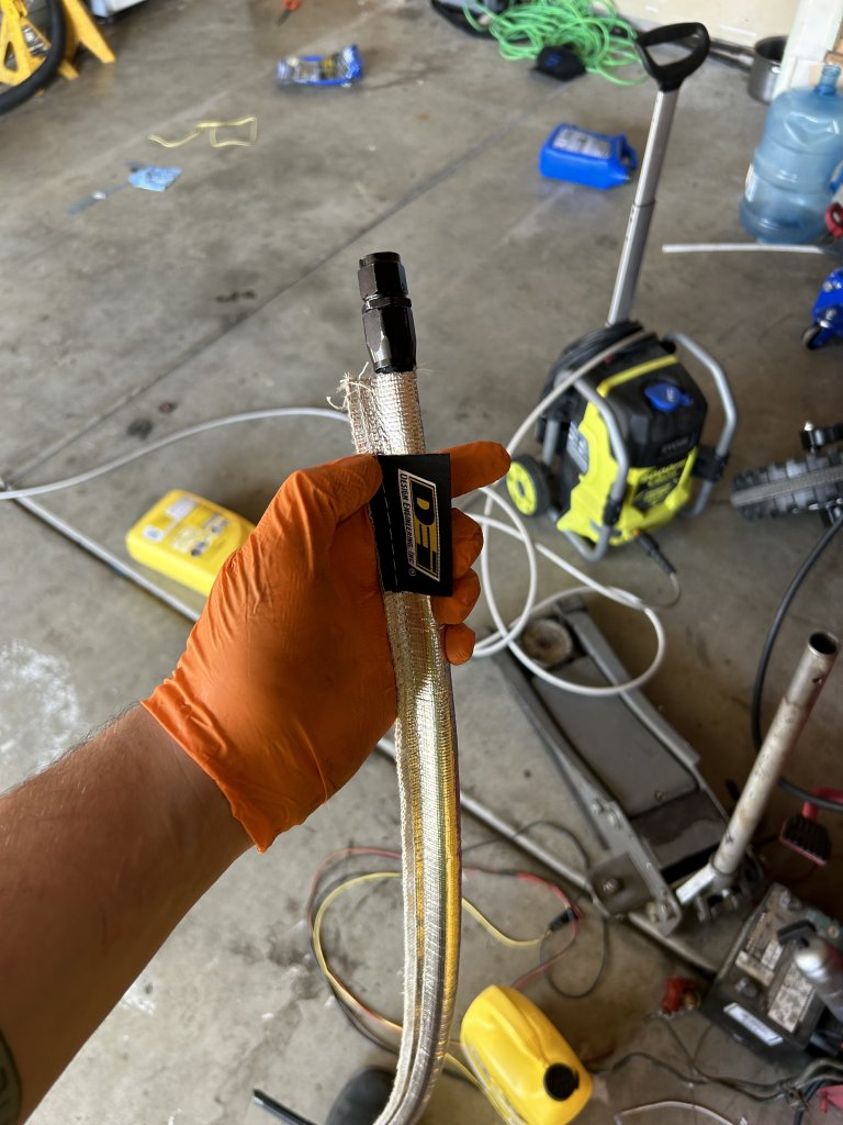

i used braided fuel line and insulated it with aluminum heat wrap tubes witch is good for 800+ degrees

The edelbrocks are notorious for not liking high fuel pressure. 6Psi is the max spec, but really it should be more like 3-4Psi. It must be barely holding on against that 6Psi while running and once it sits long enough to heat soak the fuel line a bit it is flooding it out.
