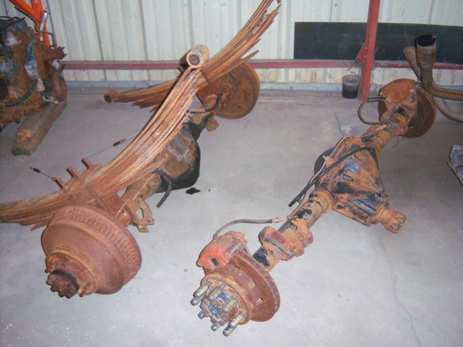

Now, this brings me to my CUCV 14B Full Floater. I bought that disk brake converted 4.56 Detroit Locker rear end for my 3/4 ton truck. I know they call them 1.25 ton trucks or D30's, so that means my CUCV rear end isn't going to bolt into my 3/4 ton truck huh??? I'd have to have the perches moved. :yucky:

Well, I'll tell ya what. Since you don't want to install it anymore, I'll come and get it out of your way for you:rofl:
47,132
9,329
You prolly won't want it when I'm done pulling the disk brake kit off of it, the gears out of it and the Locker out of it to put in my other housing. I'll just transfer the guts to my 3.21 diff and freshen up the bearings, seals and reset the lash to compensate for any wear. I paid a whole $125 for that thing, I sure can't give it up. And that happens to be the dude I bought the 88 Burb off of that I just sold too, so buying that rear end was a very very good deal all said and done.
