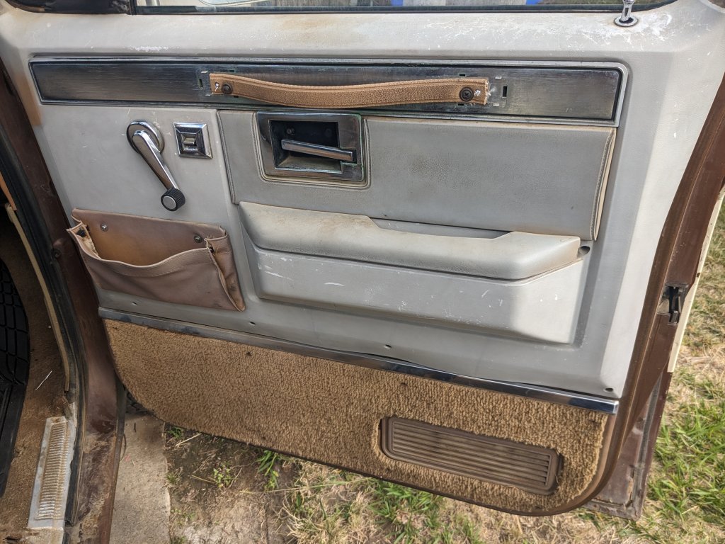

Here is the finished product...it's not factory correct nor a perfect restoration but much better than what was there! I changed the color to SEM Saddle Tan which almost matches the new upholstery perfectly.
On another note, I was missing one of the bottom retaining clips. I had some silicone mold casting stuff laying around from a hood ornament project and decided not to pay the $2 for the clip, $15 for shipping and wait for a week so I casted one up...once again not exactly a GM authorized reproduction and not perfect, but it's behind the door panel and should hold a screw!
Looks awesome! I’m about to give the plastic inside the 77 a refresh. Got a few cans of SEM on order. Need to hokey rig some new plastic studs for the trim around the door handles and window switches. Or I was thinking magnets. Glue them and metal tabs on in the right spots.
