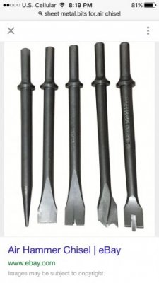

If I were you I would cut through the sheetmetal with a cutoff wheel only going through the sheetmetal and then peeling it off the plate with a chisel. I rarely used a sawsall for cutting body panels. My favorite tools for that are my cutoff wheel and my air chisel. I have an awesome sheet metal bit for it and a few custom ground ones for peeling off spot welds. The bit on the right is for sheet metal and works great!
I'm use the same method, a combination of cutoff wheels on my grinder and my air hammer.
I currently still have the upper hinge still on the truck, since I didn't think it was in the way, and why do more work than I need to? Does the rocker need to be trimmed around the nut plate? Or are the hinges the only thing holding it in place? Because I could just pull it out, that would make it much easier lol.
I dont know if its welded or not. Take the other hing off and find out.
Well I can't do that until I get home lol. I just wanted some validation for my fantasy of going home, going out to the garage, and it all working exactly the way I planned the first time.
