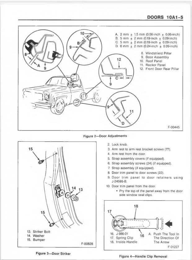

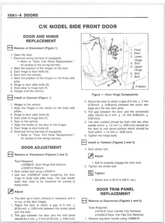

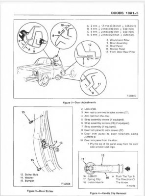

Nah nothing official like that- I just make 'em up.
Seriously, they come from the service manual but might not apply to your truck:

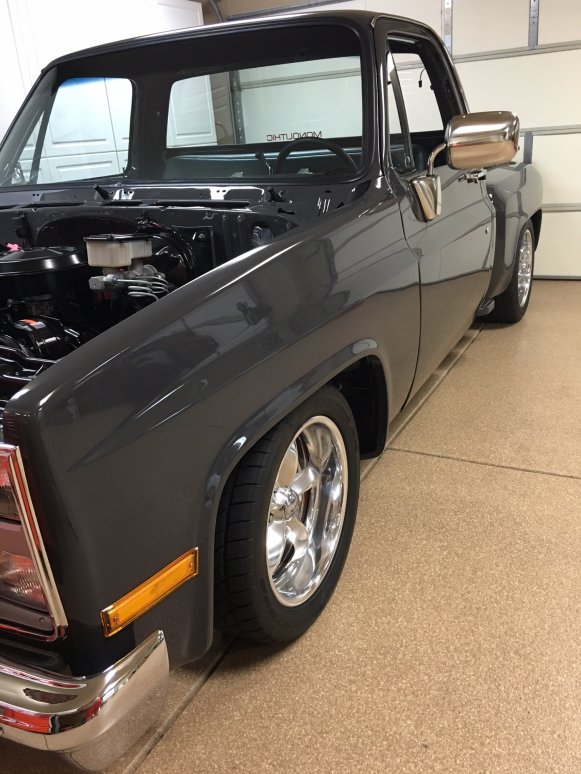

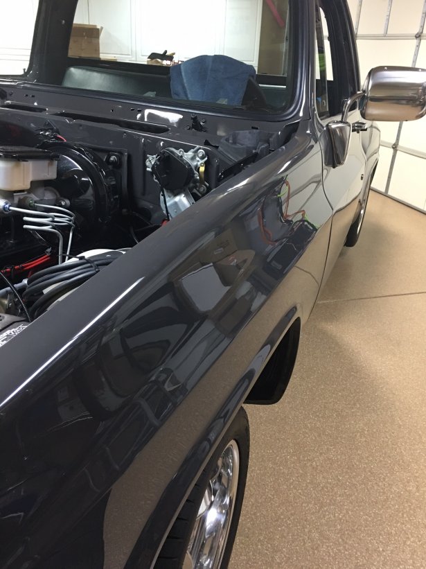

Just got done lining up my doors and fenders, not an easy task even with new hinges. They turned out good for me, before and after pics for you. Can tell the difference. Please PM me if you need help with yours.
