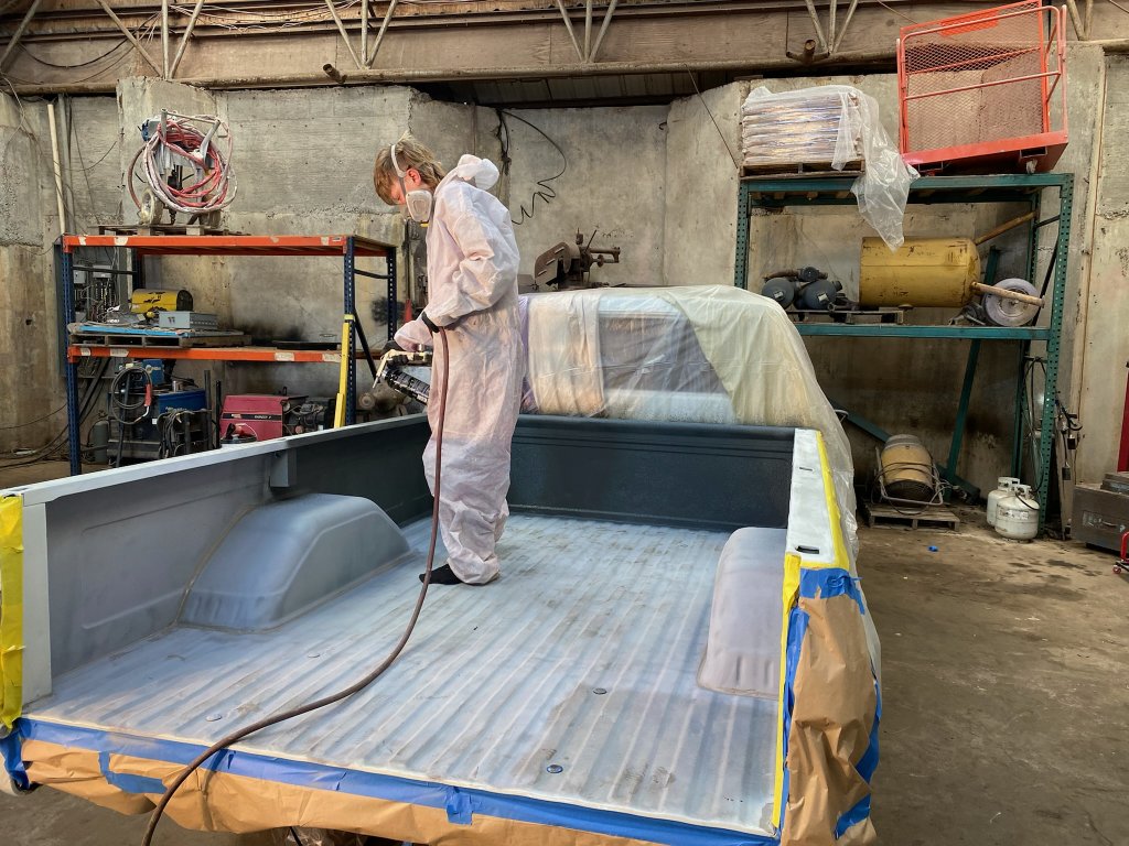

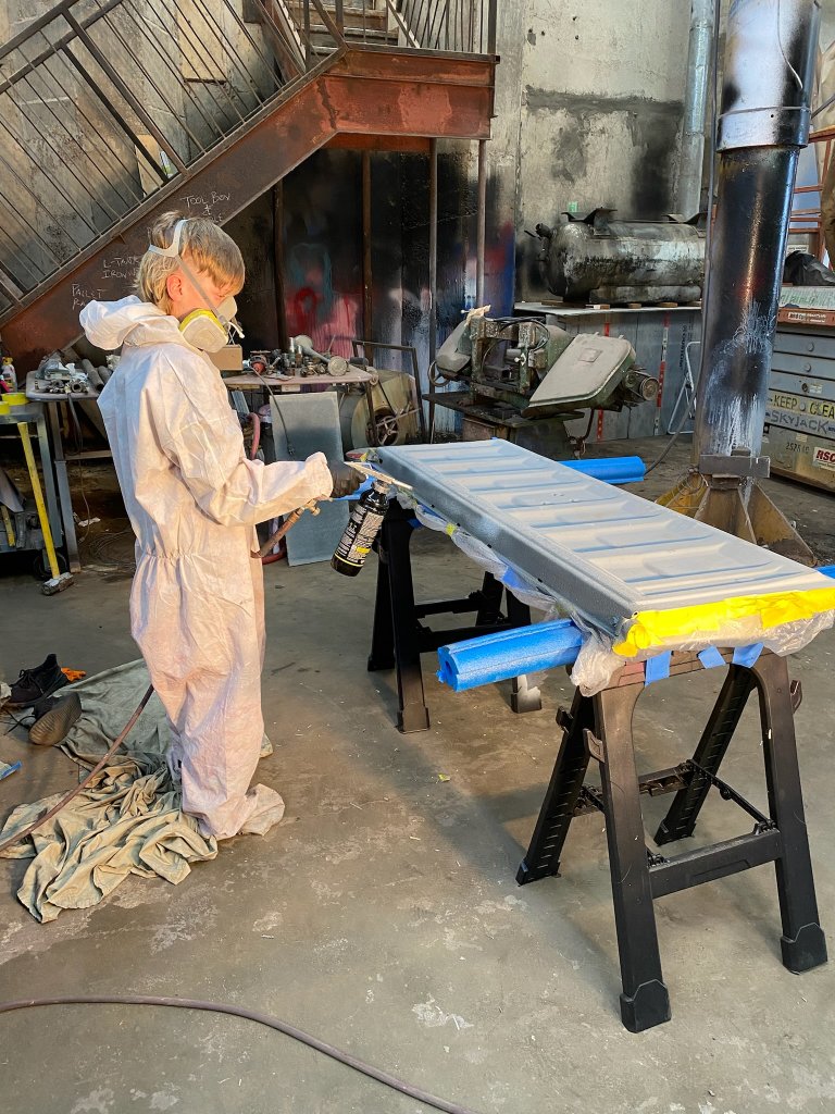

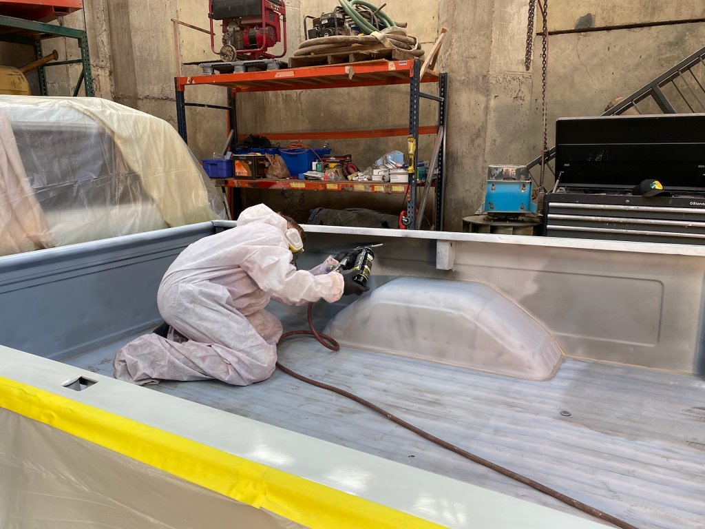

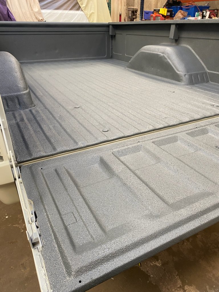

Have to say the Raptor spray in liner is lots of bang for the $$. My 15 year old truck is a budget build on his dime. With the color and the kit we had about $200 in it. Easy to apply and came out fantastic. We highly recommend this. He did the entire thing himself!

Interested in any one who has experience with the durability and longevity of it.

I used on mine about 3 years ago. Overall, I'm happy with it. Looks good, but longevity isn't anywhere near the commercial jobs. The raptor will scrape off if I drag a piece of metal with any sharp edge. I also slide 25gal propane tanks over the tailgate and it will wear through.

When I had my truck painted I had the guy spray mine. I think the stuff he used was T Rex. It's the same stuff. I am really happy with it. I know the prep was almost nothing to the bed and just shot on. It looks good and is great product. If you do the prep work I know it would be well worth the money. I'm happy with mine and it's holding up good considering!

Check out "project farm" on YouTube, he's got some videos on bedliners including raptor liner. I think the best one he tested was Durabak 18. I think raptor liner did decent, but not the best.
